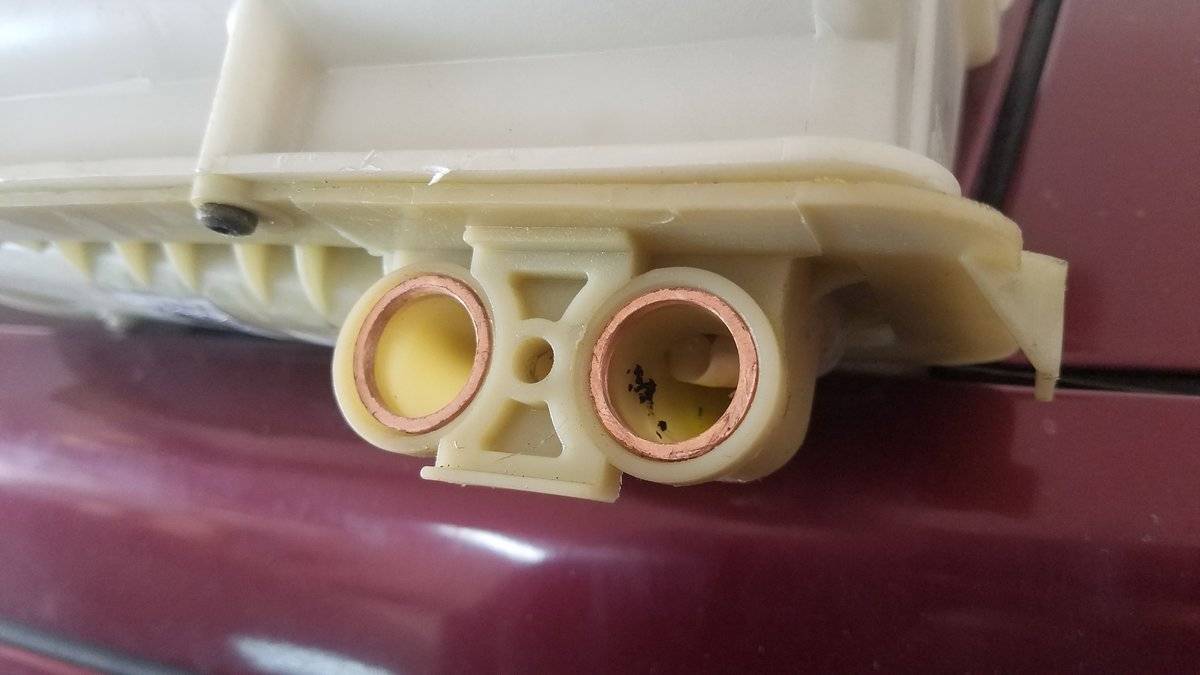

Years ago I added some copper washers to the heater core connection for a tighter seal. I did have to both drill out the inner diameter and file down the outer diameter.GreenVolvoGoldenDog wrote: 24 Mar 2026, 22:07Finishing up a heater hose replacement @ junction on the V70. No more leaks from the engine connection just above where the tran sits.
However… now getting leak @ heater core coupling assembly. Where the aluminum hoses (and new o-rings) slip into the heater core assembly and get torqued in via a T25 six point screw. (See here)

Arigato! Much appreciated, I located mine - no need to send one, hopefully it can help someone who may need it more in the future
Note to be made here, since I’m waiting for a new throttle pedal base I left the interior “unstitched” and can see the core. A U-shape bypass will need to be cut closerr to the firewall since my ‘00’s ETM/Throttle takes up more space in the footwell than the FBW.

This is a great idea… did you keep the same pitch/thread for the T25 six-point that screws between the two openings?ZionXIX wrote: 25 Mar 2026, 06:56Years ago I added some copper washers to the heater core connection for a tighter seal. I did have to both drill out the inner diameter and file down the outer diameter.GreenVolvoGoldenDog wrote: 24 Mar 2026, 22:07Finishing up a heater hose replacement @ junction on the V70. No more leaks from the engine connection just above where the tran sits.

Yes. No other changes were needed. The washers just give a little extra squish of the o rings. I haven't had a problem in 7 years.GreenVolvoGoldenDog wrote: 25 Mar 2026, 17:09This is a great idea… did you keep the same pitch/thread for the T25 six-point that screws between the two openings?ZionXIX wrote: 25 Mar 2026, 06:56Years ago I added some copper washers to the heater core connection for a tighter seal. I did have to both drill out the inner diameter and file down the outer diameter.GreenVolvoGoldenDog wrote: 24 Mar 2026, 22:07Finishing up a heater hose replacement @ junction on the V70. No more leaks from the engine connection just above where the tran sits.

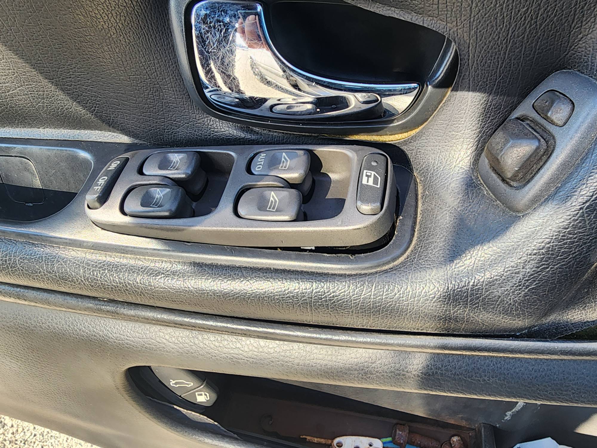

Replaced my front mount finally after owning the car for 6 years....
And I ordered the other 2.
I replaced the gas struts for the hatch, and tried to install a new drivers switch, but it won't go in for some reason
