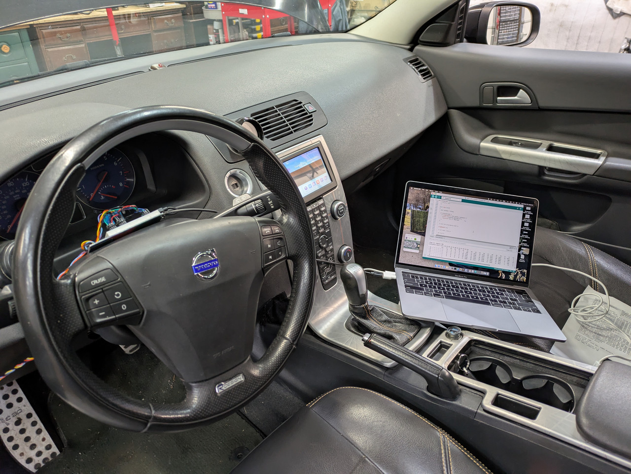

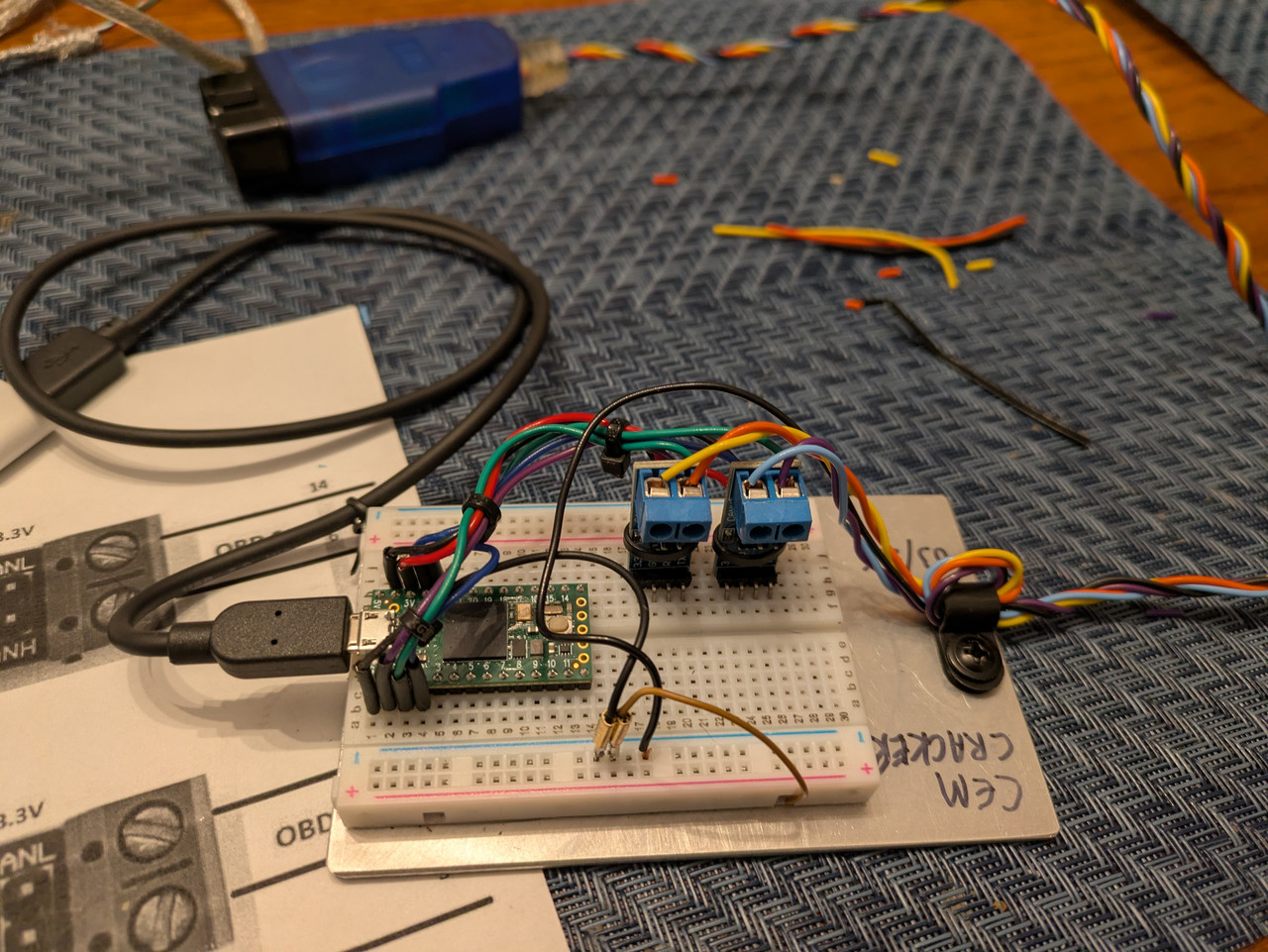

Thank you for all your assistance. I tried alternate CAN boards, with no change - still returned the PN = 0.vtl wrote: 20 Mar 2026, 19:49No. This resistor is not used in fact, not until you put a jumper. In-car cracking does not need this terminating resistor.lookforjoe wrote: 20 Mar 2026, 19:33 Should I remove the 100ohm & put 10K in their place?
The Waveshare boards (only version I can see with a brand name) have the same resistor setup

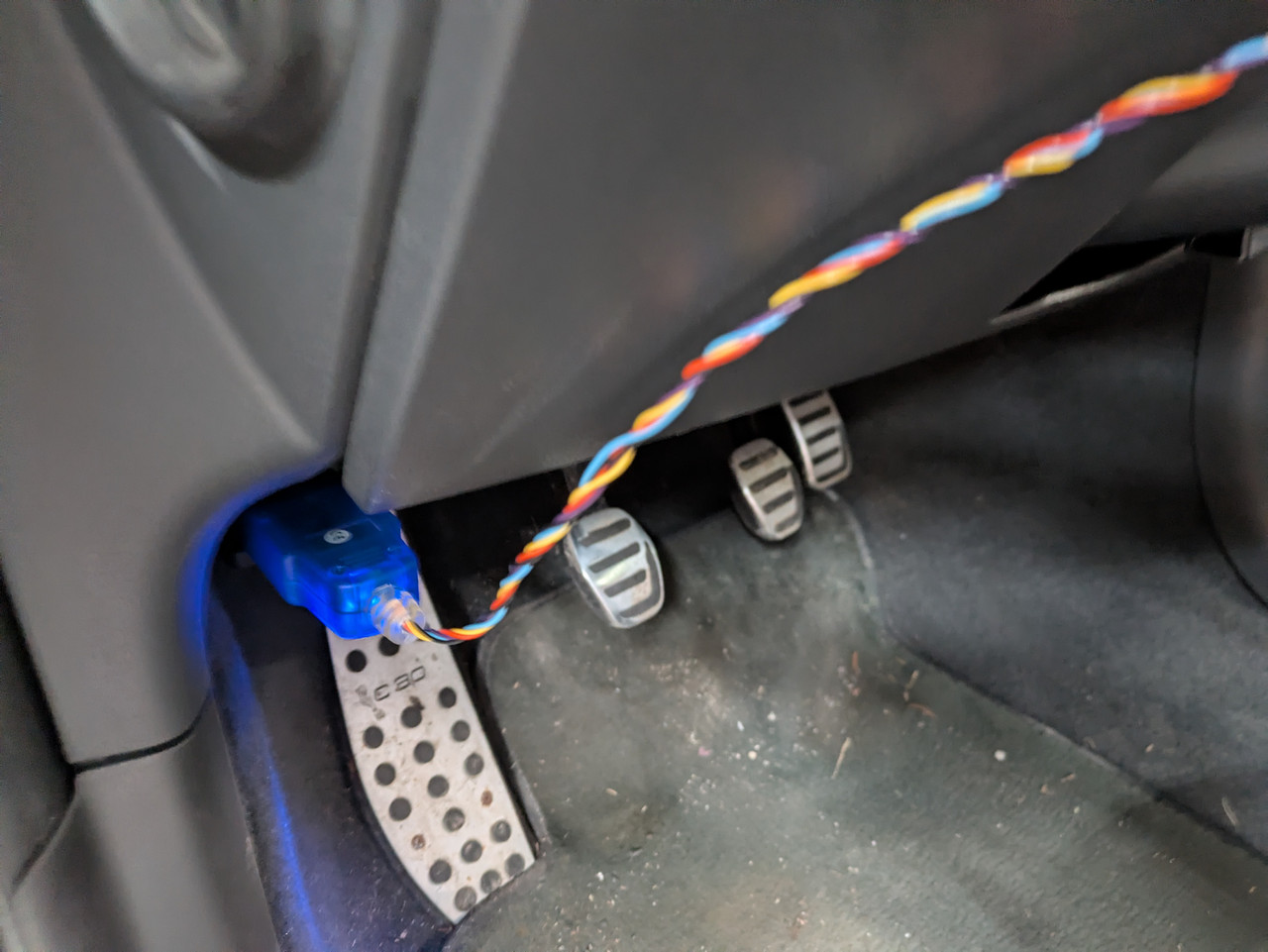

So, I cut up another OBDII cable, this one was meant for use with a VW software package. I re-wired it for the needs here.
This time when I plugged it in, it activated the info module - that never happened before -
Ran upload from Ardiuno IDE, and this time it ran!

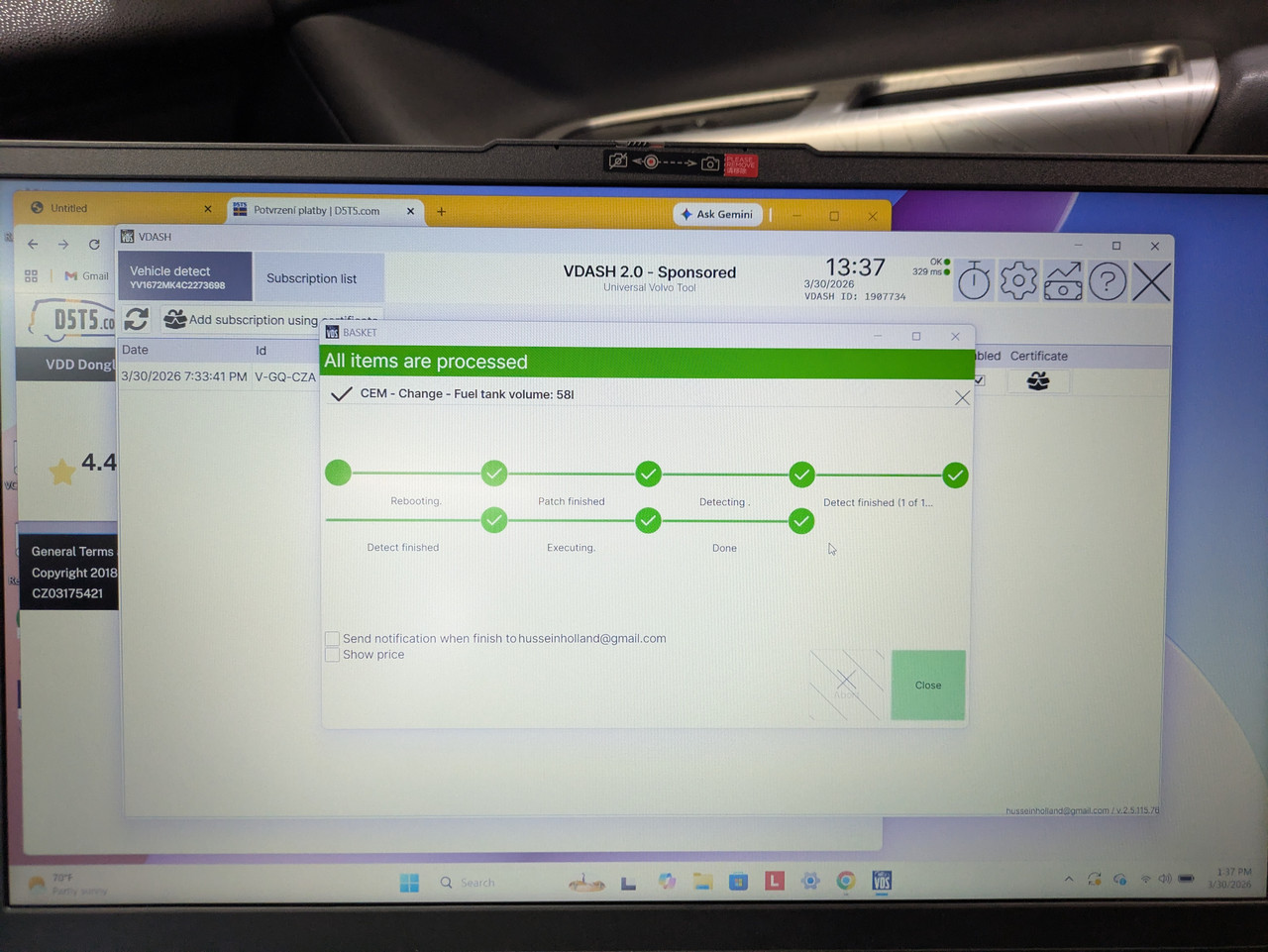

I did! Thank you so much for your guidance. After that, I was able to get the subscription, and change the fuel tank size to the AWD capacity (I had already pinned the CEM for the 2nd AWD tank signal) - I've been living with a wonky fuel gauge for the past 8 years since I did the AWD conversion, so hopefully that's a thing of the past.

In the meantime though, I bought Teensy, CAN communicators and a used CEM from a scrapyard and started experimenting. The short story is that I can't make it work and any help would be appreciated.
So I am in the correct cem-b branch and when I run the code unmodified I get the "Unknown CEM part number 0...". I tried hardcoding the part number and other stuff, but with no success. Teensy seems to crash after "Reading RAM.." line.
I don't use additional 5V power to the board. I use 12V transformer for the CEM, powering E3, E6 and B3 (read this in the thread) and grounding E1. At first I have switched the CAN transceivers connections to the CEM but have fixed that.
