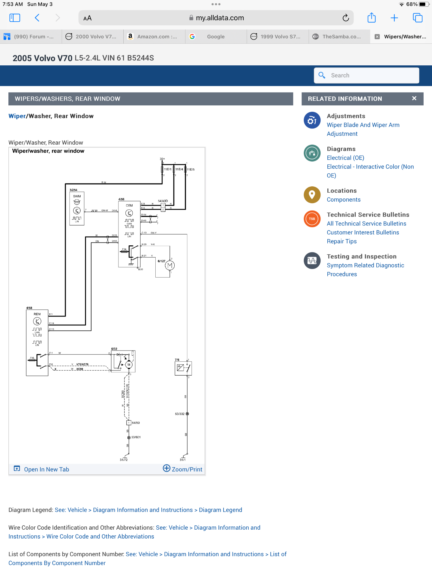

Rear wiper out onthe p2 , here’s the wiring
Fuse is ok, haven’t checked voltage at fuse yet
