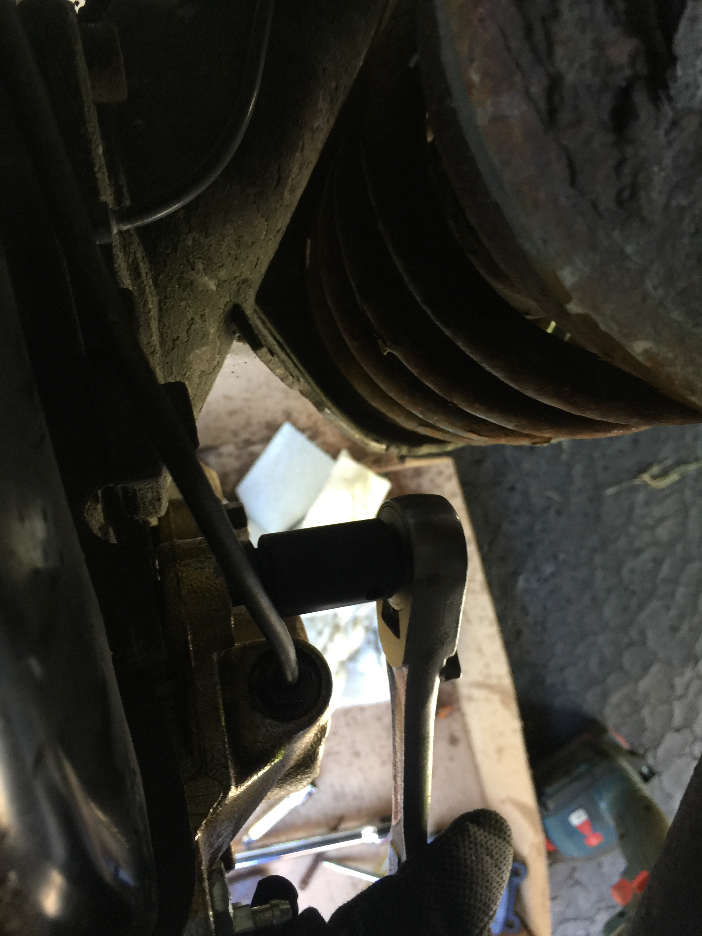

Re: using Volvo originals is why I harvest decent looking calipers from upulls. The other aspect that abscate finesses is the frozen rear brake lines. Not only might the line itself seize on the nut, but at least on the right rears, the nut threads usually seize in the caliper. If you are able to get the brake line fitting/nut loosened, look at the threads; are they sharp and clean, or somewhat rounded? The last calipers I installed (almost brand new harvested off of a 94 850 so the nuts did come loose) I ran a tap into the threads and sure enough, the threads were rough, especially on the right rear one. I suspect that's why the line fitting on that one is usually extremely difficult to remove; they weren't cleanly bored.
Plus, the flex hose that crosses over the rear suspension arms can become constricted so pressure to the right rear can be less than spec and pressure that does get through can become trapped in the hose, so your caliper freezes up. What fun dragging a locked wheel around in winter.
I got disgusted fooling with these and just renewed the lines and the hose—well worth a couple of hours and less than $30.00 in parts. I'll never have a problem with those lines or fittings again. I didn't take pics. Maybe I'll snap a few to add to the writeup.
