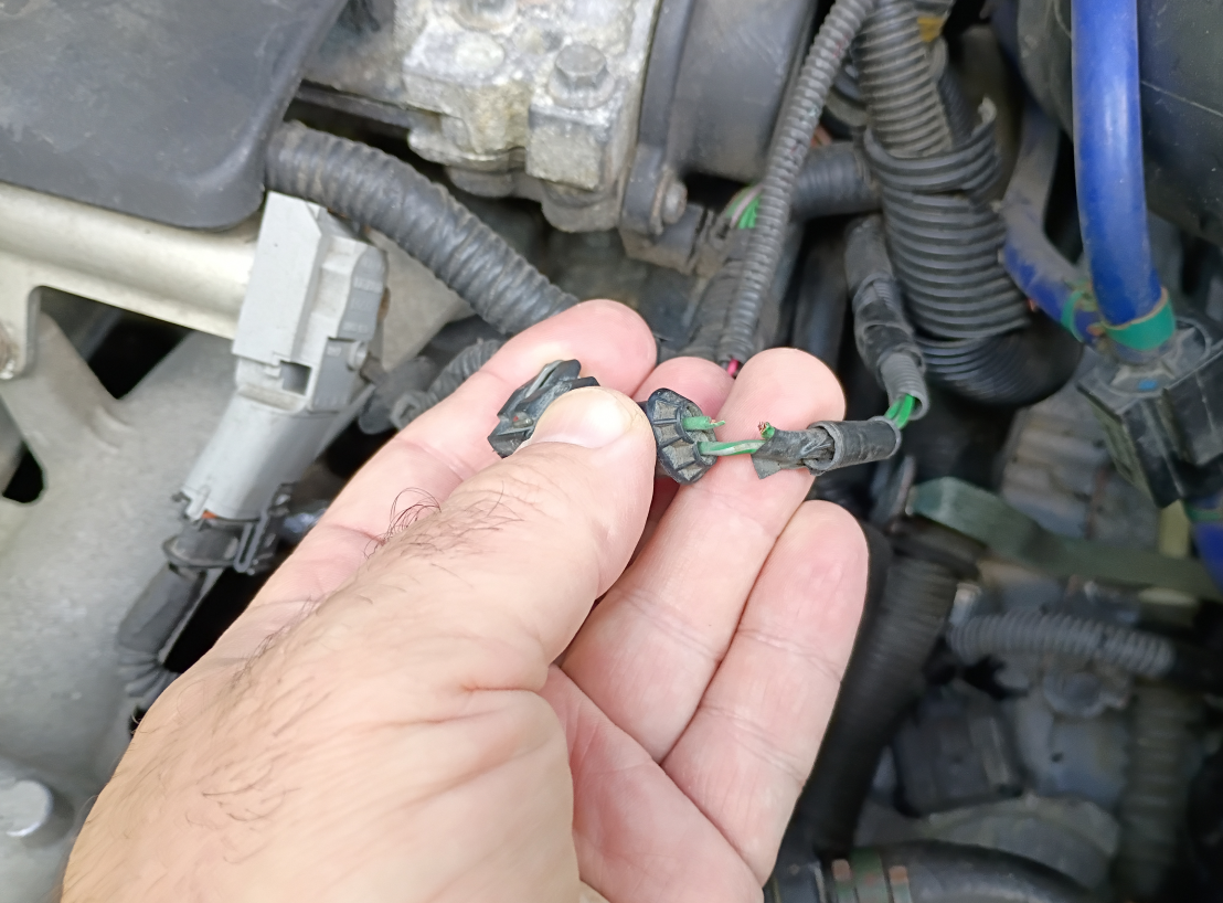

jonesg wrote: 22 May 2026, 07:20 Early models had external relay, yours is molded into the module on the fan.
note, I snipped the violet wire near the headlight because I didn't want to back feed voltage into the ecm, disconnected battery too.
I don't like messing with the electronics on this car at all.
a coat hanger soldering clip helps hold the wires for soldering, i used heat shrink and liquid tape to seal the joint from moisture.
its an awkward position, you can only get one hand in there.
