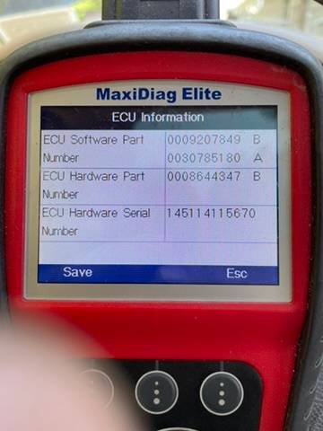

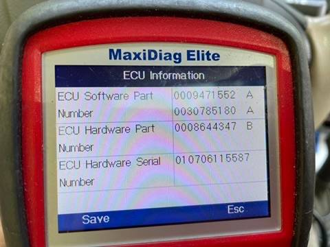

Obviously this combination worked.
This unit is an original MM from Volvo build date 98W032
- ECU software info
- 18280C70-9EBD-459B-A4C3-F01FD83C2F1B_1_105_c.jpeg (111.98 KiB) Viewed 11528 times
- ECM software info
- ABE695A9-50CB-4B6A-A8A9-683598A2DA82_1_105_c.jpeg (117.9 KiB) Viewed 11528 times

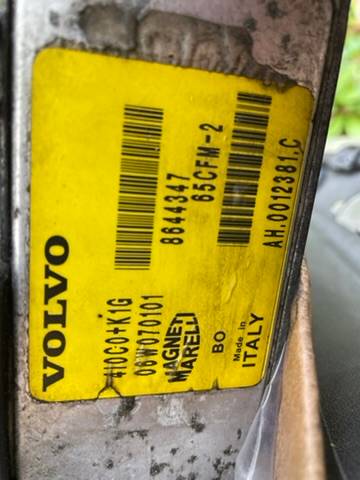

Here is a yellow Label from another 1999 S70 AWD that passed self test, shortly to be put on car for drive test
- Build label 2006 W07
- 09883D31-19DF-4296-8A9C-8D576483B2FC_4_5005_c.jpeg (42.57 KiB) Viewed 11528 times

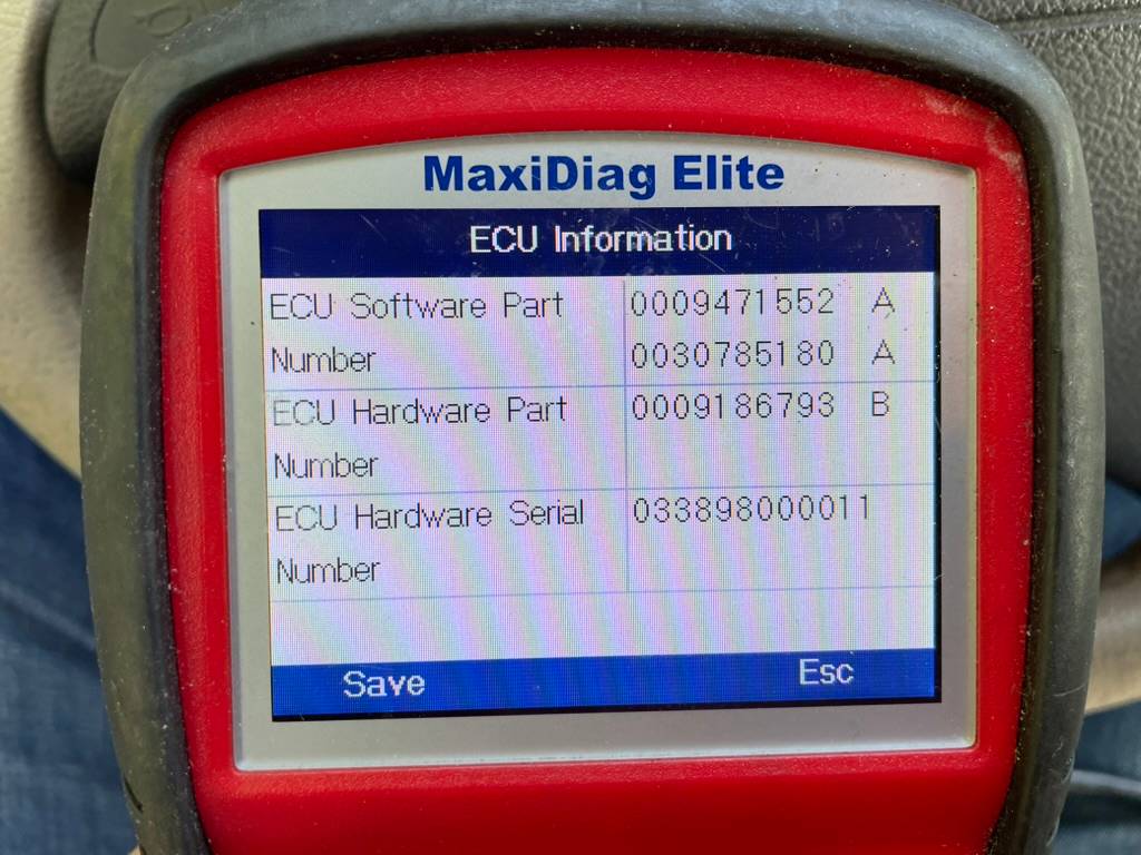

- ECU software
- F38093AB-0FD4-45E7-BC8C-EB4D1B93D3FD_4_5005_c.jpeg (39.04 KiB) Viewed 11528 times
- ETM software
- EB234CF3-18B2-4B96-A6F3-FB2AF43B2FC0_4_5005_c.jpeg (38.94 KiB) Viewed 11528 times

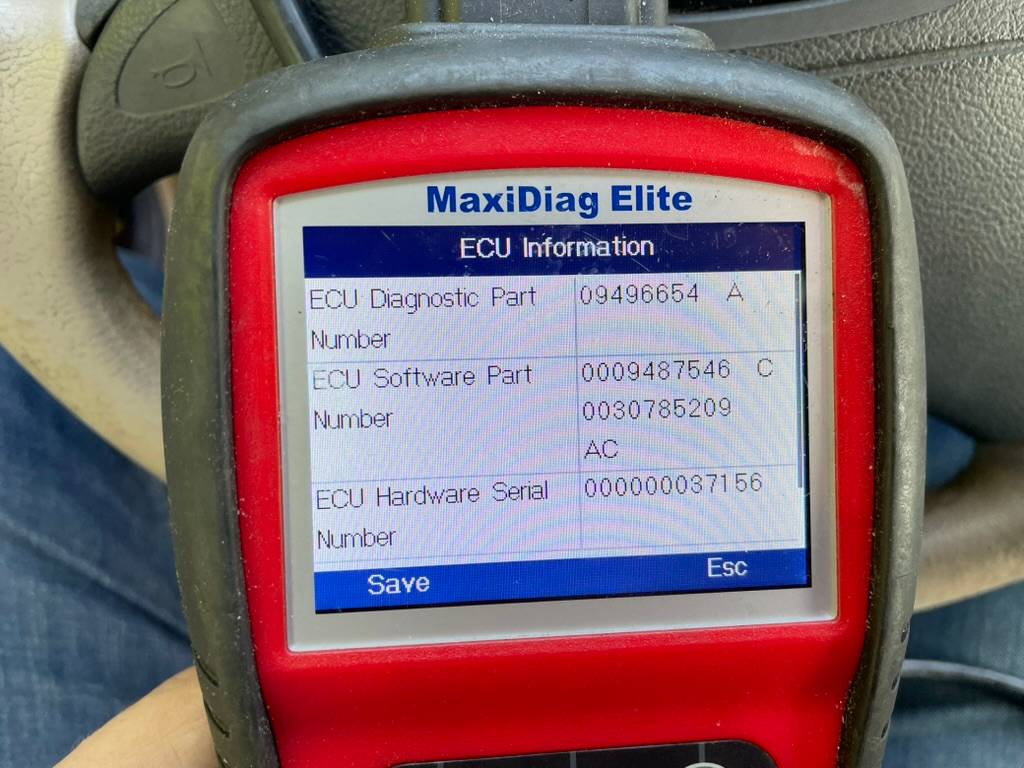

This one is the late model contactless white lable
It did NOT pass self test on athe turbo AWD S70 - Is suspect it is a NA software unit?
ECU REV WAS SAME AS one in first post (same test car)
- 0C0E8665-7A52-404B-B15C-4B9FC375BC7C_4_5005_c.jpeg (42.29 KiB) Viewed 11528 times
- ECM SOFTWARE REV
- D3006734-4D6D-49A7-BFB6-E0038F1DF256_4_5005_c.jpeg (37.8 KiB) Viewed 11528 times
