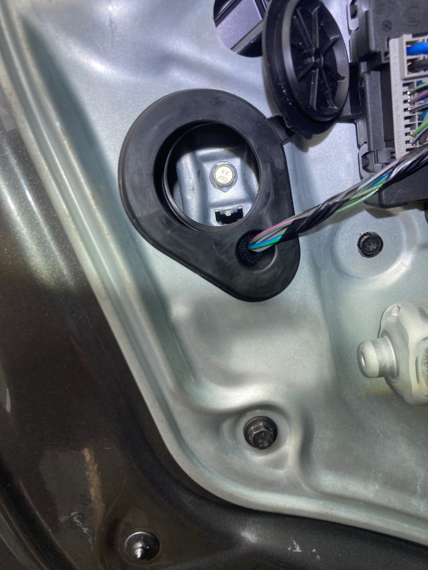

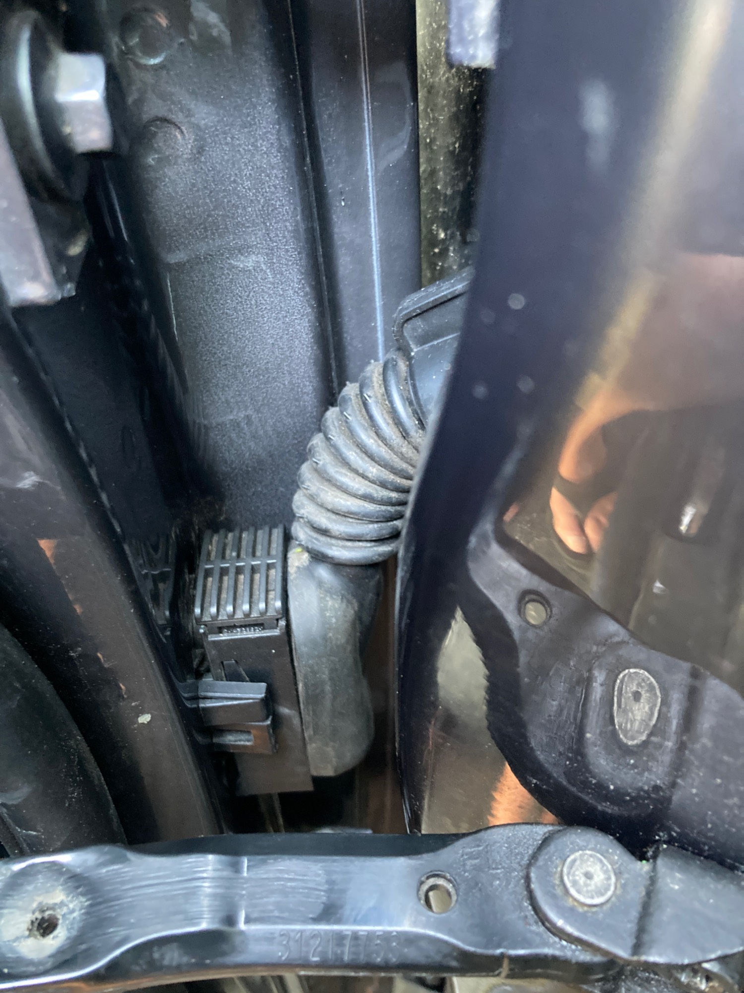

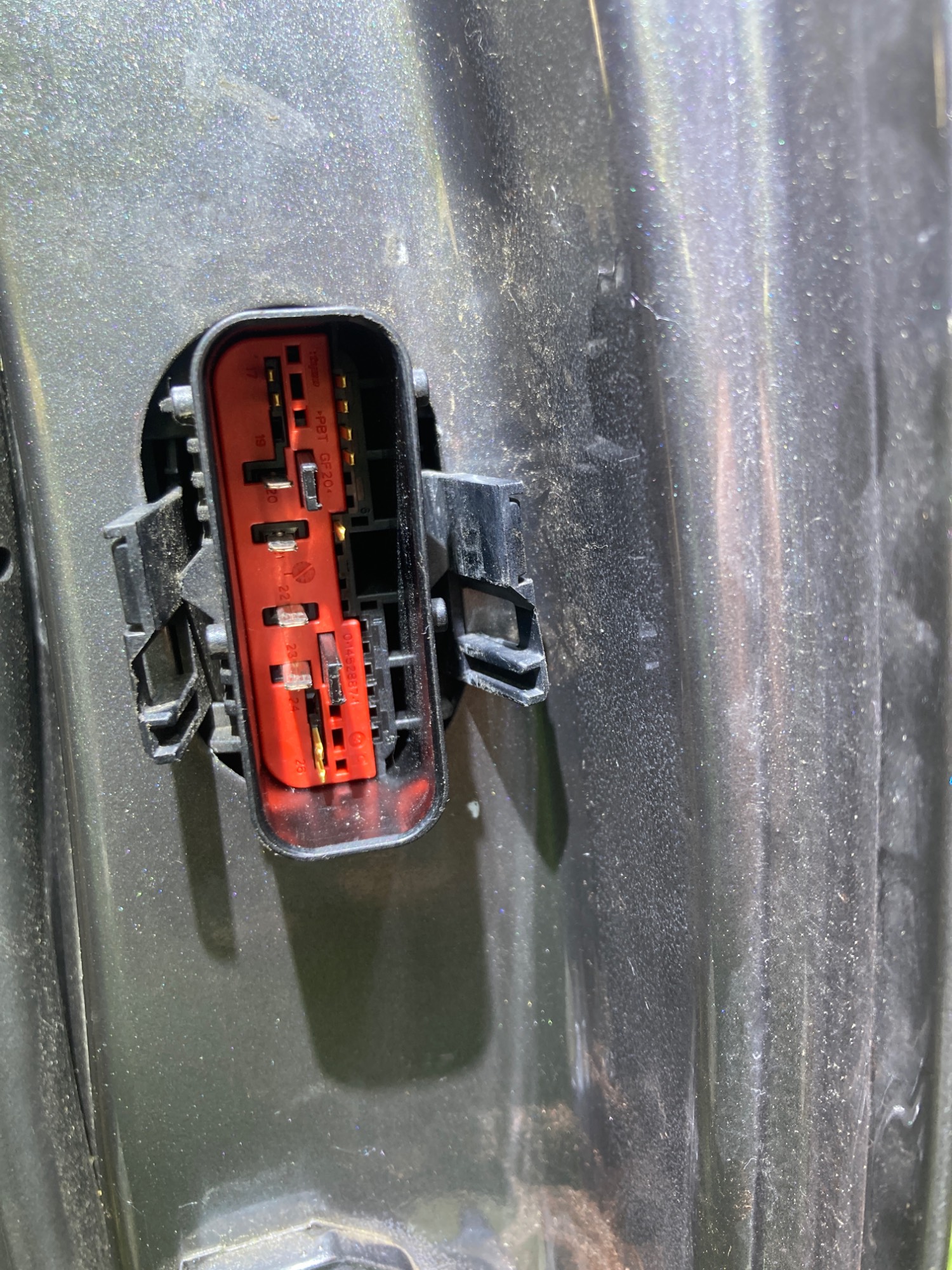

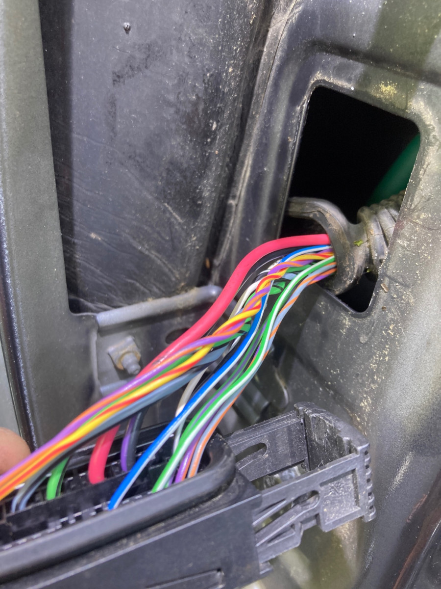

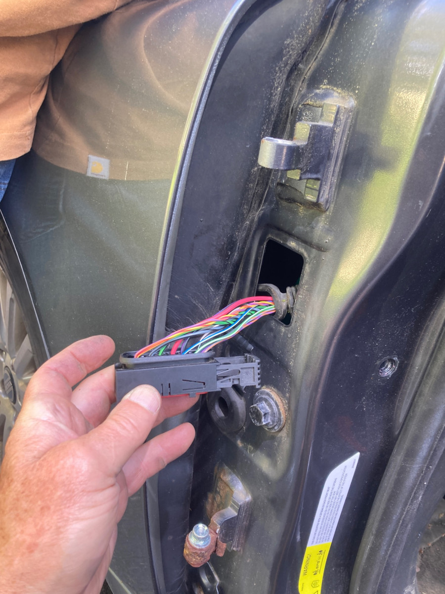

Well I thought we had it fixed! I examined the door harness connection and wires. Surprising the wires are in excellent shape! We did notice the the connector that sits in the door was not seated properly. We fixed that but we have the door ajar alert still.
Note: this connector is interesting, there are two locking parts. The side clips get pushed upward to release the clips, and then the flat ribbed part on top get pulled upward to disconnect the connector ( it literally pulls/ pushes the connector into place).
Anyway back to the drawing board on this one.
Here's some pics of that connector Also, this inspection revealed a bad lower door hinge pin, rusted and loose.

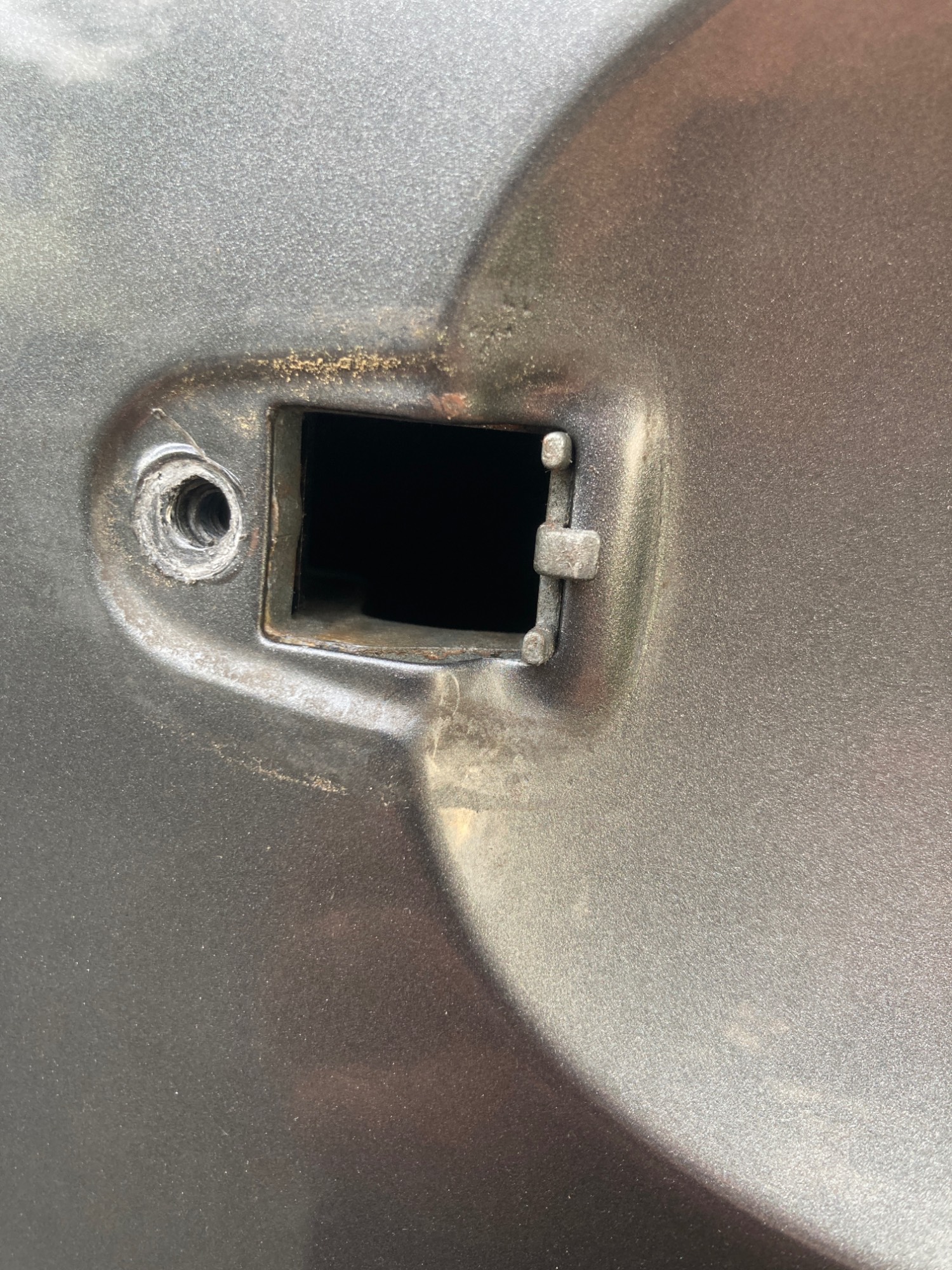

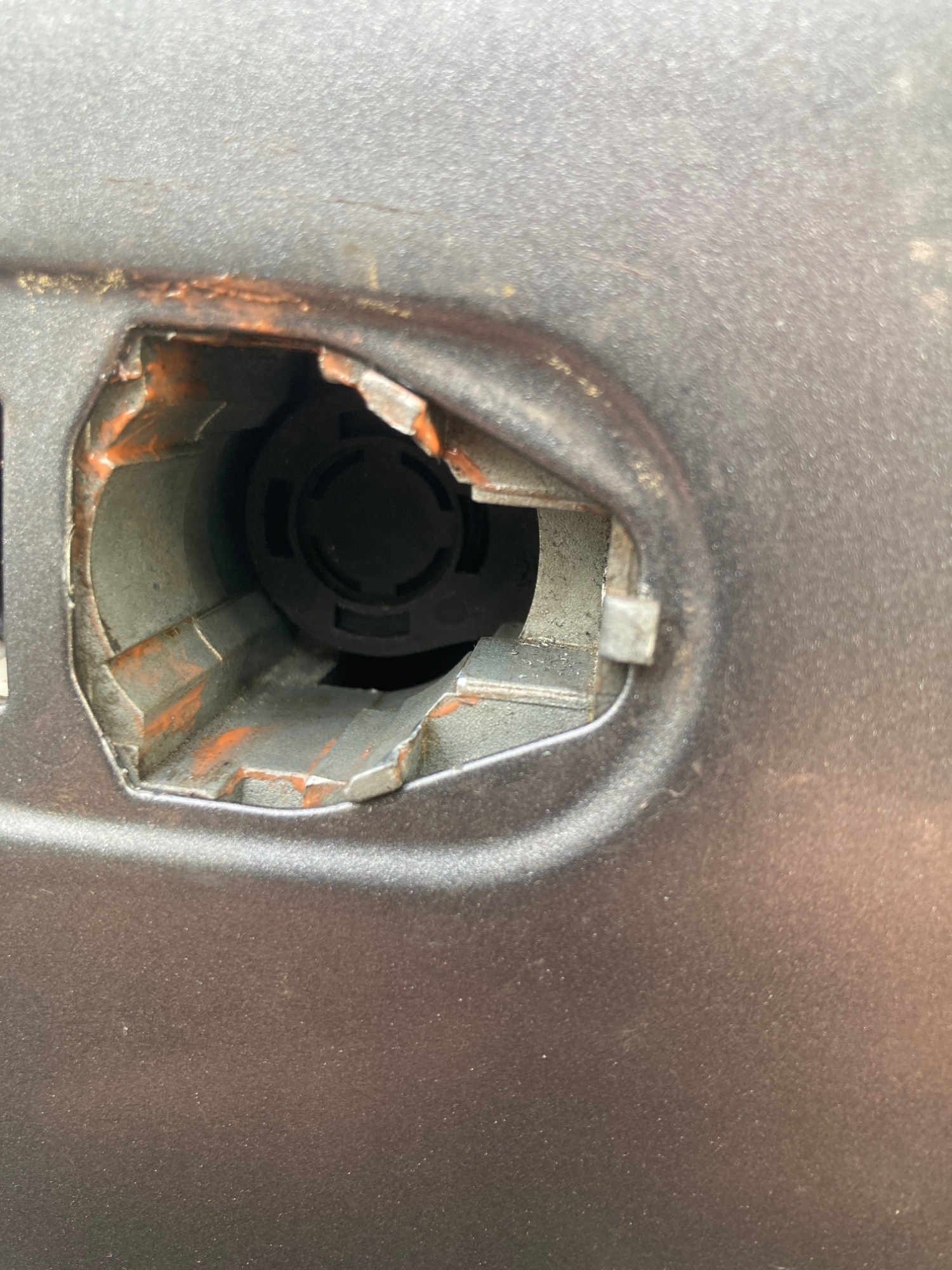

Installed a used driver's door lock actuator last night (and this f**ing morning). I did not have fun at all. The used part had some broken stuff on it which was fix with parts from original lock assembly. Everything is back together but when putting door panel on I broke a couple of clips and dislodged the push button lock arm from actuator!!!! Car will not have a push button lock on it until I get real bored and fix it. (It will be easier the second time, I'll elaborate).
Just a couple tips if you haven't done it before.
1. On this model Volvo S80 3.2 2007, the window is removed by lowering window to gain access to two 10 or 12 mm bolts that loosen a clamp that hold the window in place. The bolt heads appear in an access hole in the inner metal door panel, unlike other models there is no plastic bracket clips that you push while pulling window up. Much easier.
2. This royally screwed me up; under the threat of rain and darkness, I screwed the inner door handle mechanism of the outer door handle in place without properly aligning it. There are a couple of metal "nibs" or hook-like protrusions that mate with the opening in the door skin. I didn't appreciate their importance. I struggle to seat the door handle and outer lock until it poured down rain and I gave up. This morning with better light I sorted it out. I've added pictures in case someone is as clueless as me.
Door lock appears to be working fine so far. We'll wait and see if the random "door ajar" alert appears. Frankly at this moment I don't care.

That’s a really high quality wire connector , expensive too. Most other manufacturers use cheaper stuff that lasts the warranty period then breaks
