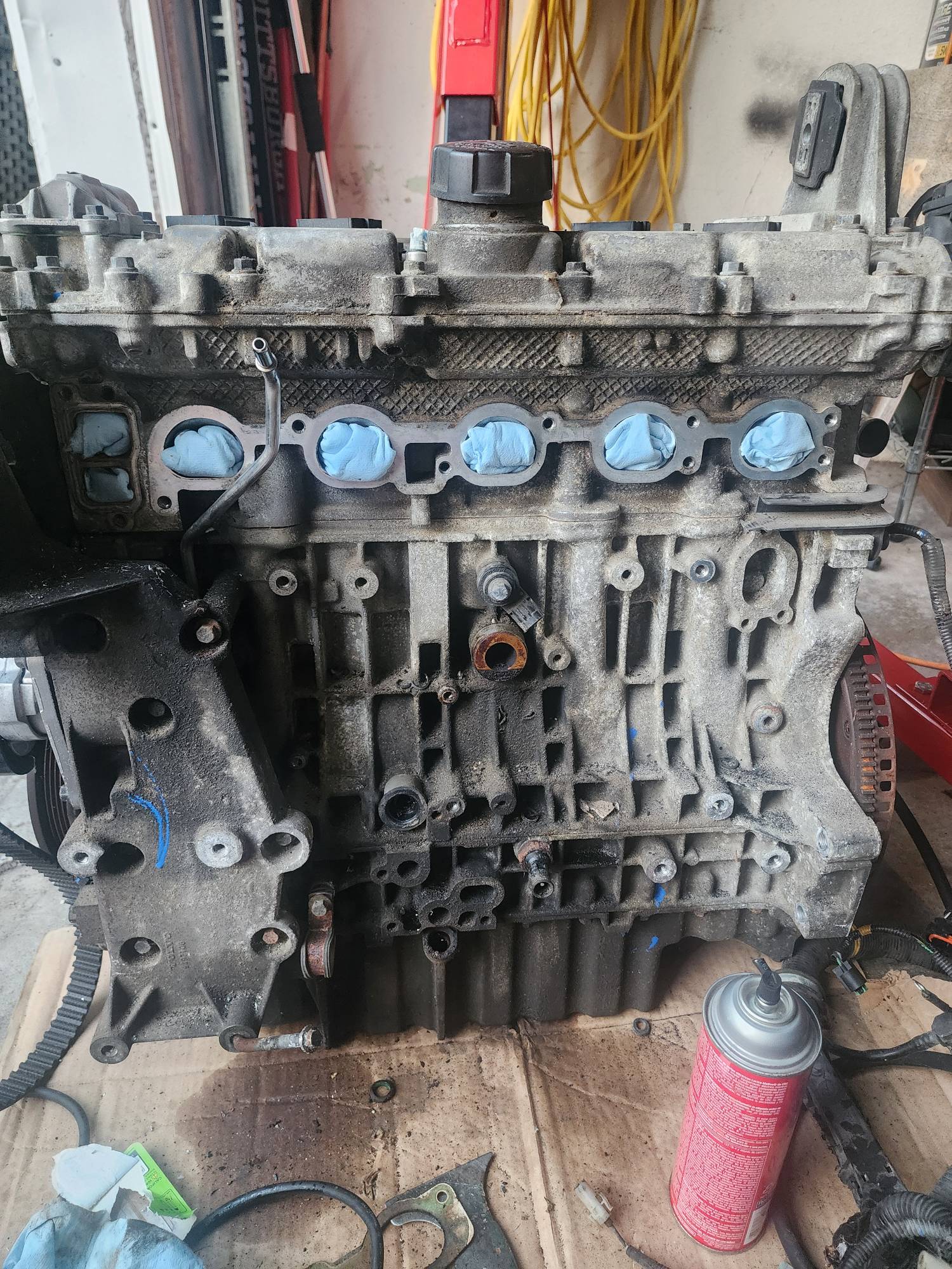

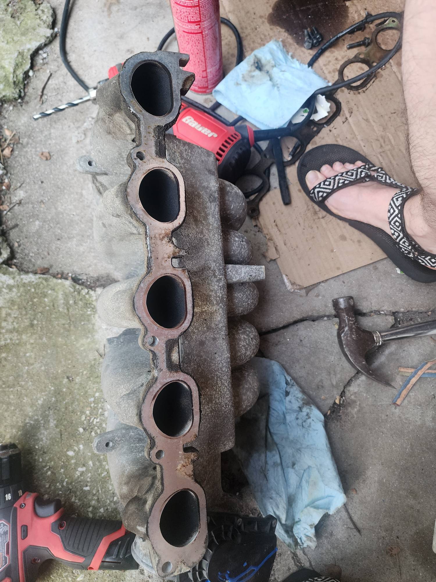

So I got the manifold off (drilled out the stripped torx heads) and below are some pictures. I'm very new to this so I don't really know if there are signs I should be looking for. I don't want to open the head if I can possibly avoid it but I also don't want to miss something important. Any advice would be greatly appreciated. Also any tips on cleaning the outside of the block?

A 50/50 mix of vinegar and Dawn dish soap in a spray bottle is good on aluminum. Use various stiff brushes and wire brushes, rinse it off.

Just be careful that high pressure doesn't shove water into places it ought not to be.
