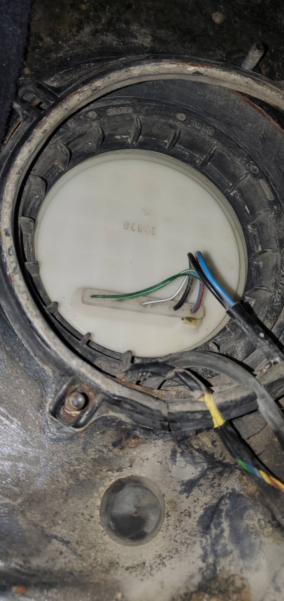

I opened the passenger side of the fuel tank first (after a half hour of vacuuming and cleaning dirt and junk to keep it all from falling into the fuel tank):
I found some burnt looking coloration on the fuel sensor card and the little contact arms that slide over the ceramic resistor card:
Second view of the contact arms:

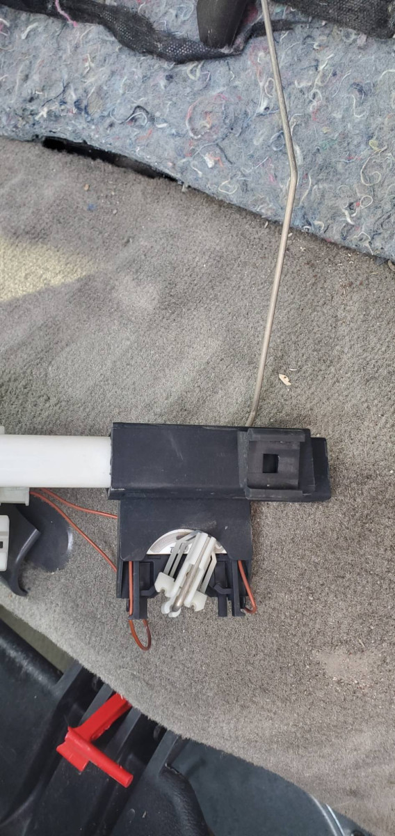

The fuel height sensor looked to be identical between the left module without an external harness and the left module with the external harness. I went to a couple local Detroit pick-n-pull junkyards to try to get a replacement part because the left side part isn't available by itself and the right fuel height sensor is $216 from Volvo and $67 from Bosch.
All the junkyard P2 Volvos I looked at had the no-harness left modules. I opened one and was able to remove the fuel height gauge sub-assembly without much difficulty by unplugging the electrical connector from the bottom of the flange, sliding the float arm off, and then unclipping two plastic tabs while sliding the part out of a plastic slot.
Original and replacement part next to each other. The markings on the edges of the resistor cards are identical:
Another view of the fuel height sub-assembly showing the two snap tabs that hold it in position:
Another view:
This swap for the discolored/burnt looking part for a used but unburnt part worked and eliminated the error codes. Fuel height function appears to be working. I will update if there are any future problems with this fix.
