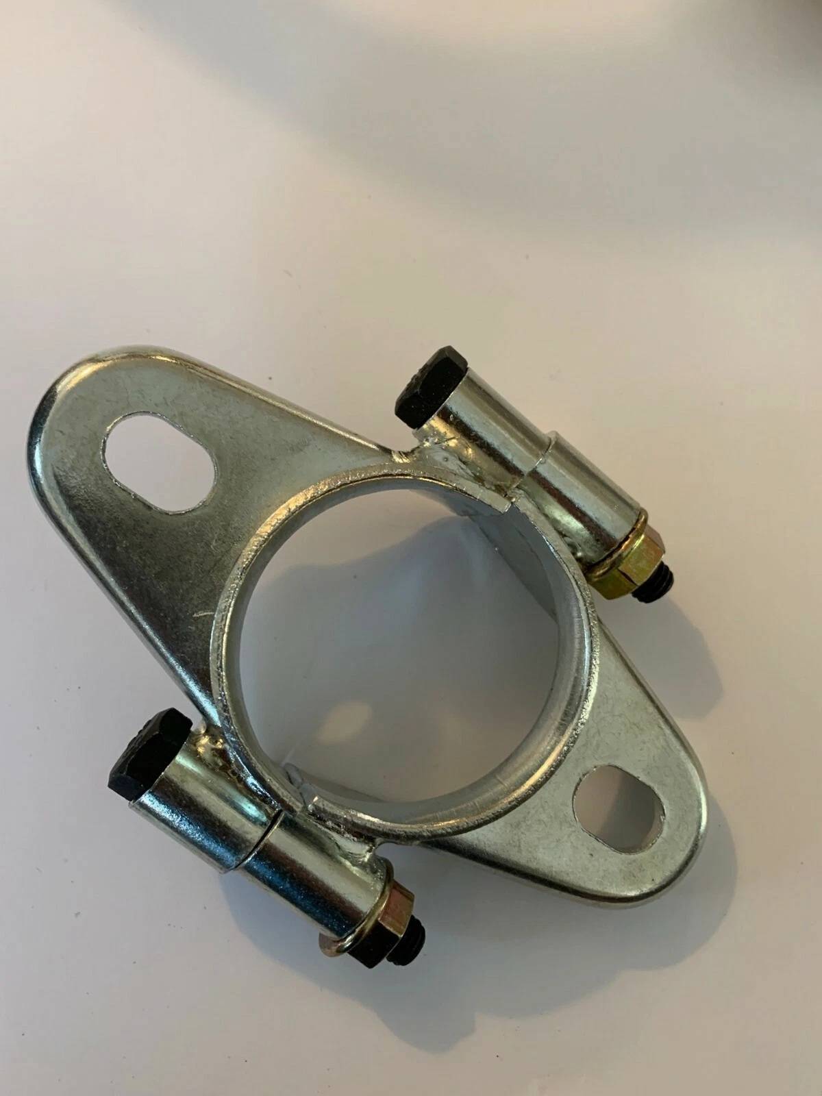

Keep it simple with a split flange instead of a welded flange. Make sure the ID matches the OD of the existing pipe.
