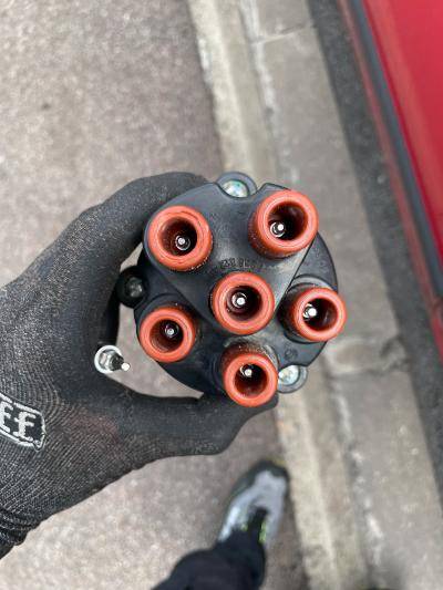

hi I'm trying to start my car after it suddenly stalled on the road. I have a fuel odor and no spark at the plugs when cranking. Rough idle when it started
Here's a non exhaustive list of everything I've done since:
  • Replaced fuel pump relay
  • Replaced spark plugs
  • Replaced crankshaft sensor
  • Swapped ignition coil
  • Swapped spark plug wires
Today I checked the distributor cap and rotor. Looks good to me since I'm not an expert ?
I'm a bit desperate so any advice is welcome.

Is that a crack in distributor rotor at 2 o'clock position? It appears that your car has intermittent loss of spark based on your story . It appears that you were due for maintenance anyway, so for $40 I would put a new rotor. Then I would concentrate on ignition module..one can either replace it for $80 and hope it will work, or find diagram and check all the powers, grounds, controls to it and after they verified call the ignition module bad.

It's hard to tell from the photo of the rotor, but the upper right and lower right bolts appear to be missing.

jreed wrote: 06 Aug 2026, 05:27 It's hard to tell from the photo of the rotor, but the upper right and lower right bolts appear to be missing.
Oh yeah sorry the bolts aren't missing, It's just I took the picture when they were off.
