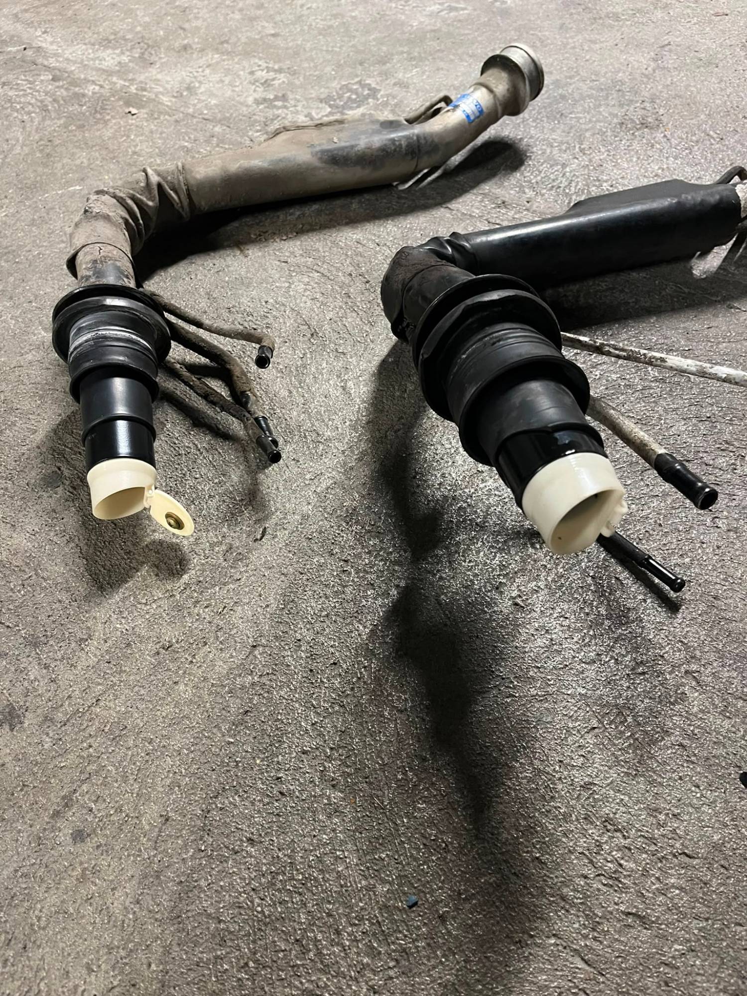

Replace the cruise control vaccum pump and the fuel hose.

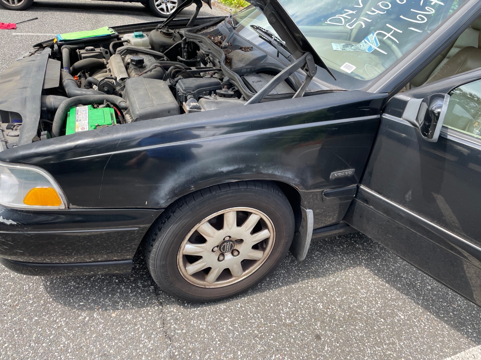

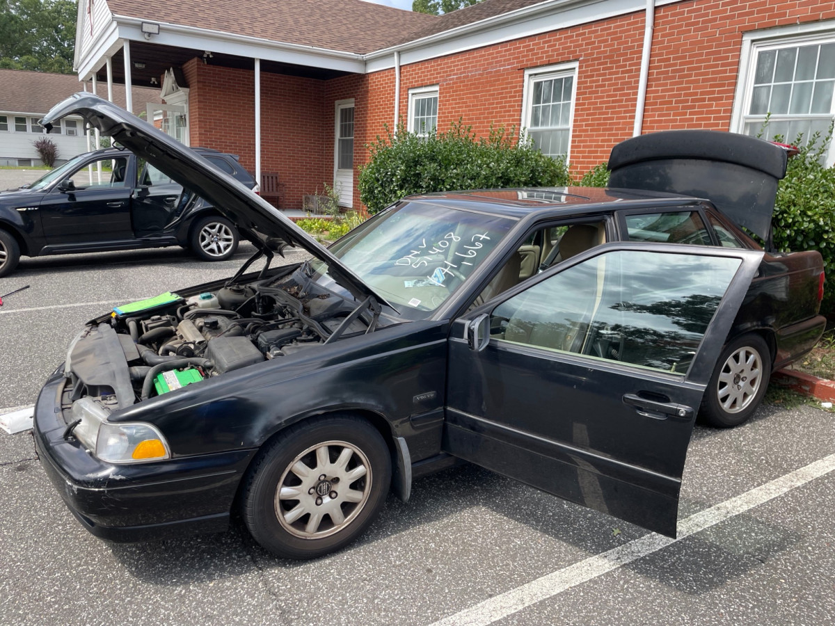

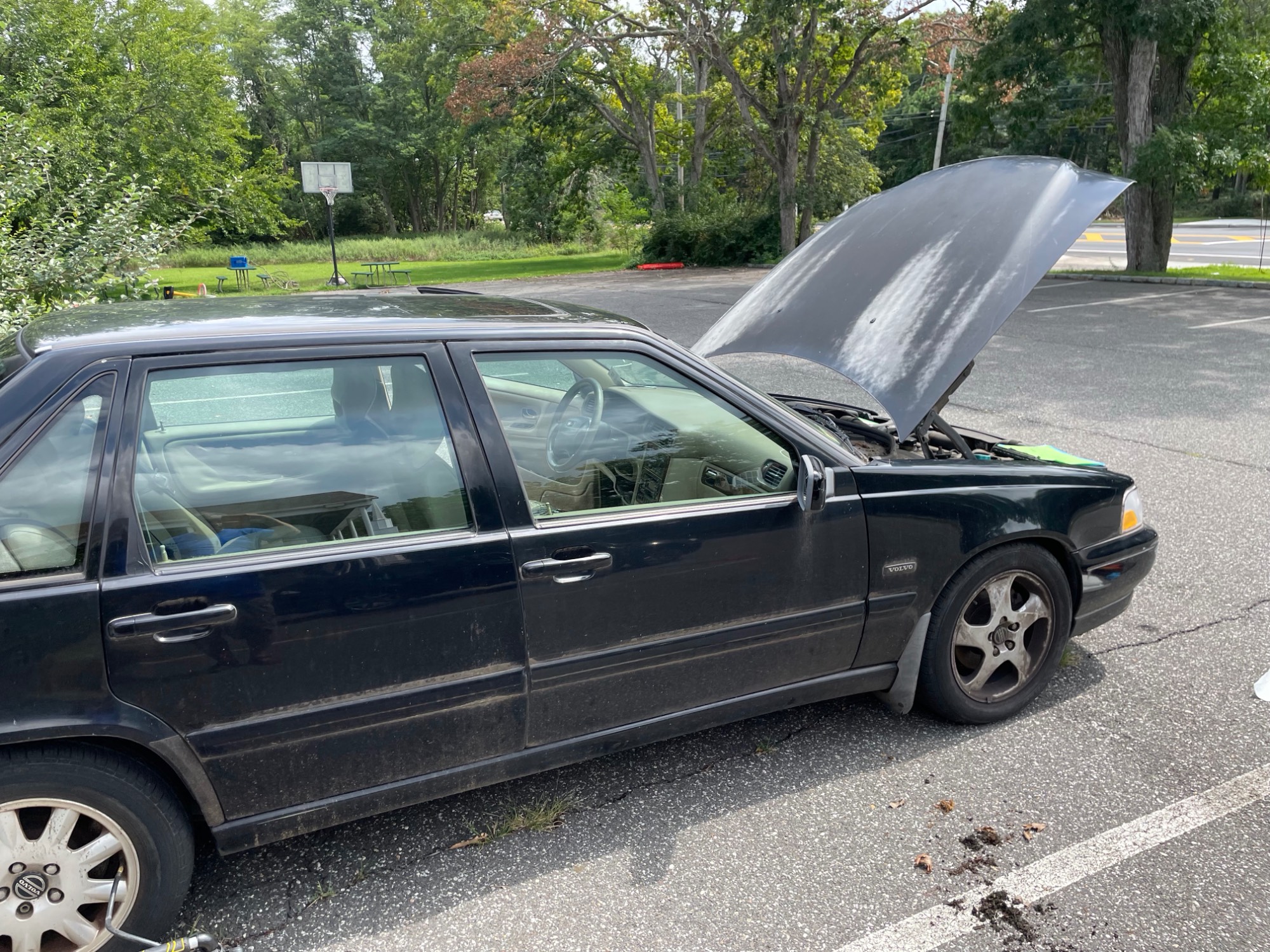

Whipped through “ Christina” my latest 1998 turbo S70 Beryls Volvo
Fluids all decent , no leaks
Brakes 5mm all around
Tires old but solid tread

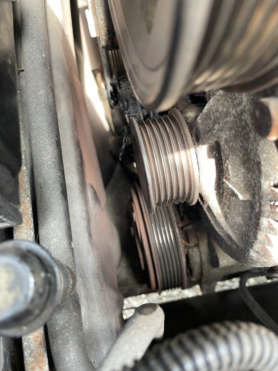

Needs serp belt
Battery 11.4 volts
Paint 019 rough
Interior fair
Smooth starter and runner

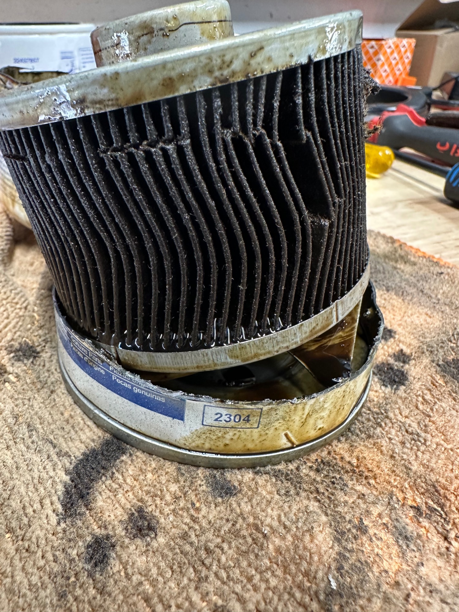

A month ago I cut open the fuel filter and oil filter that was on the car when I purchased it last year February.
Not sure how old the those are.
There was no grit or any rough feeling on the oil filter.
It looks like metal particles on the filter, but I can’t remember if it was inside the filter or from the Dremel.
I’ll have to pay better attention when I cut open the new old filter that I replaced again earlier this year.

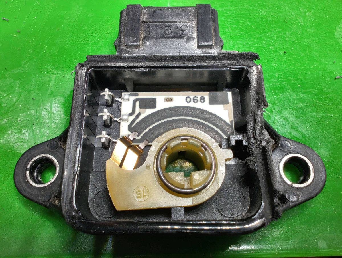

I started driving my 850 again this week, and noticed a "flat spot" when accelerating (push pedal more, nothing changes, until much later).
Sometimes it is good to take a break, then you notice these things more. I was chasing 2 codes from before, 231 and 233, idle fuel trim and long term part throttle.
Today I was sure this had to be the throttle position sensor. I had a new one in stock and replaced it. The "old" one (it is really not old) does indeed cut out to open at one point at ~50%, I measured it.
Had to reset the ECU completely to get rid of the garbage it learned and right now it is working again as it should. hope it stays like that.
I decided to cut open the sensor, and it looks like new. now it also doesn't cut out any more... but I am not going to reuse it.
Just a small story, and a problem fixed (I hope).

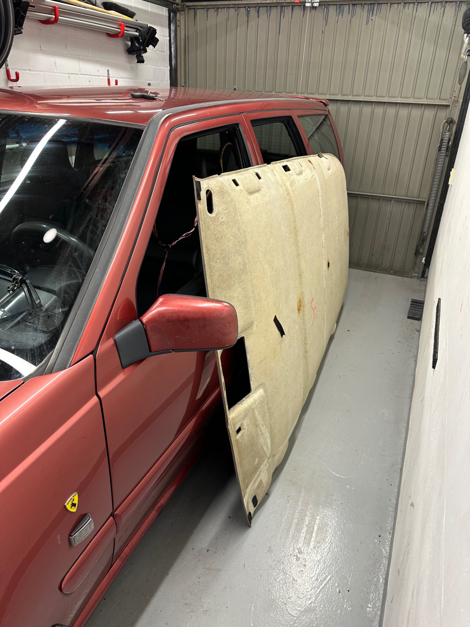

I spent 1 1/2 hr removing my headliner. I’m going to temporarily install the other one and clip it in the back anchor point and the 2 anchor points at the sun visor location.RickHaleParker wrote: 31 Aug 2026, 17:30I would use a trailer. Cover it with a blanket a hold it down with bungee cords.Chieber wrote: 31 Aug 2026, 16:46 Has anyone ever transported a headliner from a wagon?
Found one in good condition at the local junkyard today.
I would’ve installed it as much as possible there, but I forgot I have to remove this crusty antenna, sand the rust off and paint it with a protector. Afterwards I’m installing a DAB aerial, as the coverage from the stick on antenna isn’t good enough for me.
