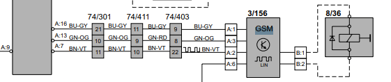

GSM Module A is apparently the electronics unit attached to the gear shift module itself. So its the GSM-A talking to the TCM

I'm guessing this means there is an issue on the link between the GSM and the TCM.
The TCM provides power to the GSM and the the gear indicator lights work fine, so power and earth are probably ok. But if there is any corrosion it might affect the error rates on the single LIN line and maybe the units just give up if the error rate goes too high.
The three junction connectors (all labelled 74/xxx) are buried too far in the bodywork for me to get at, so I'm focusing on the connections at each end.
I can see the connector on the GSM, but where is the TCM? I want to see of the connector on that side is ok, or if there is any corrosion. Is it under the airbox and is the connector accessible without pulling too many bits?
