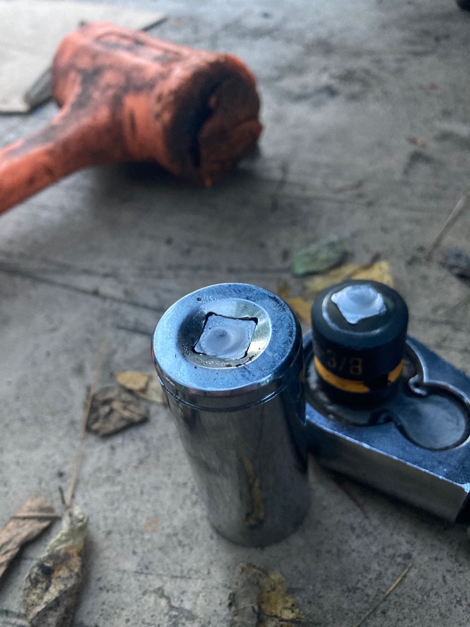

This impact converter chose a new life while removing the driver shock “spindle” with a ratchet & breaker.

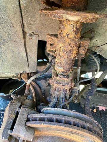

Yeah, 3/8 stuff is too small for breaking bolts free on front suspension. The power of heat. Propane heat breaks the bond of stuck threads much better than any torque device. Use liberally
Heat got this suspension apart without broken fasteners or tools.
