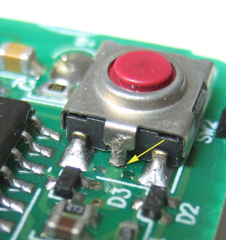

If only one of the buttons does not work it could be a loose solder connection inside the fob. Small, hard to see, use magnifying glass. Case attached, see arrow. Easy to fix with micro soldering tip or hot pen. Paul W M
- IMG_6924_detail.jpg (102.63 KiB) Viewed 1103 times
