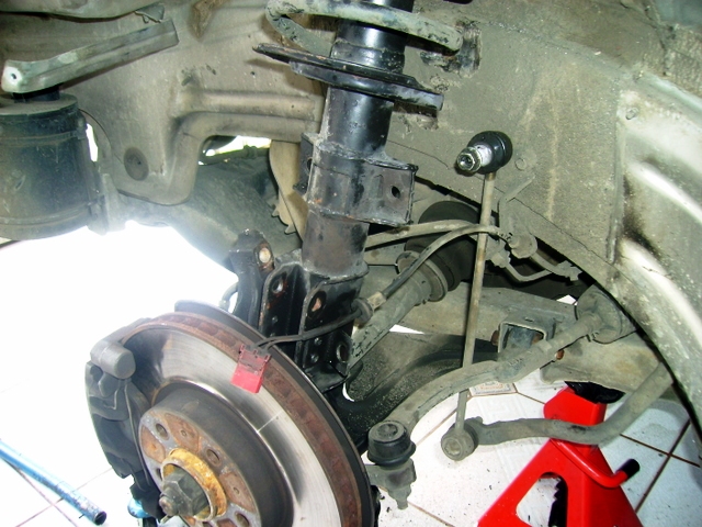

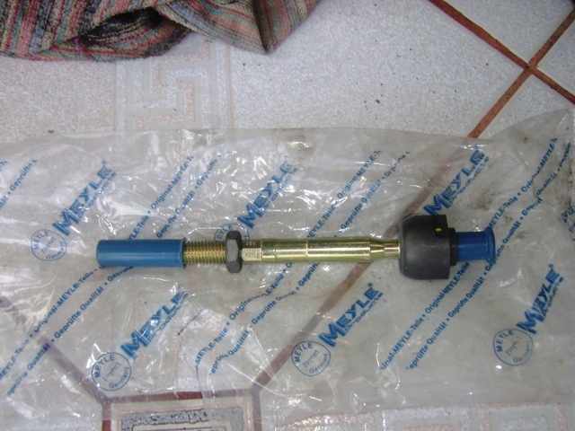

hi,

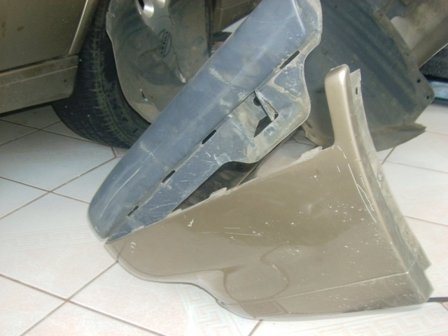

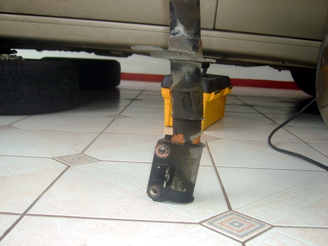

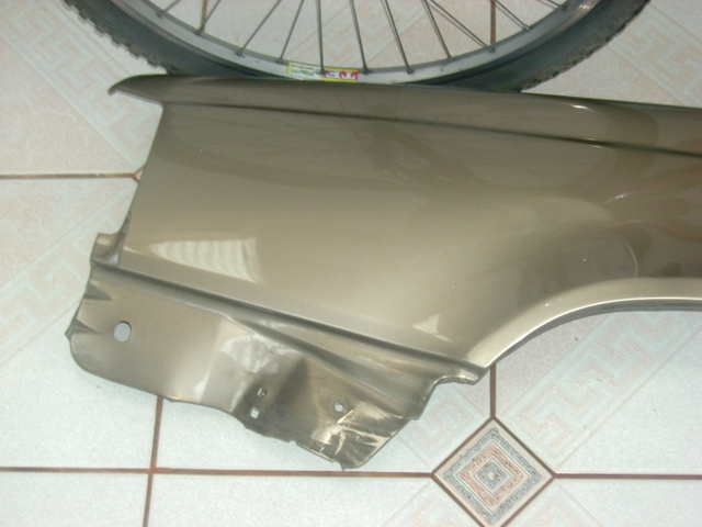

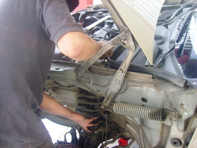

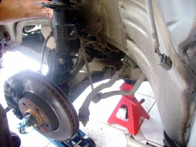

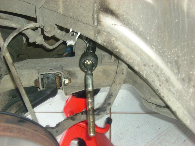

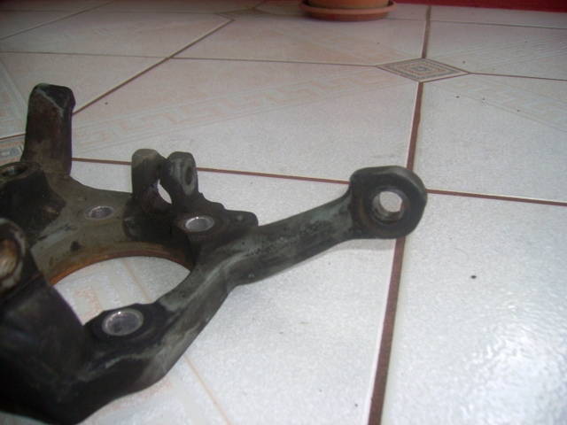

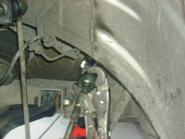

I had crash with another car, the whole impact was in the front right wheel, the impact was so hard that I needed to call a tow truck... well the whole afternoon I was dismantling the front of the car, I took off the bumper, part of the right side of the car, to see the damage... the shock adsorber is twisted completely but I could not take it out of the car, I will have to look for a mechanic to be able to take out the piece of the car.
what more could be damage?
thanks

subframe
axle
hub/bearing
wheel (rim)
lower control arm
sway bar and/or links
bushings
You basically have to take an inventory of everything in the impact zone and inspect each very carefully.
axle
hub/bearing
wheel (rim)
lower control arm
bushings

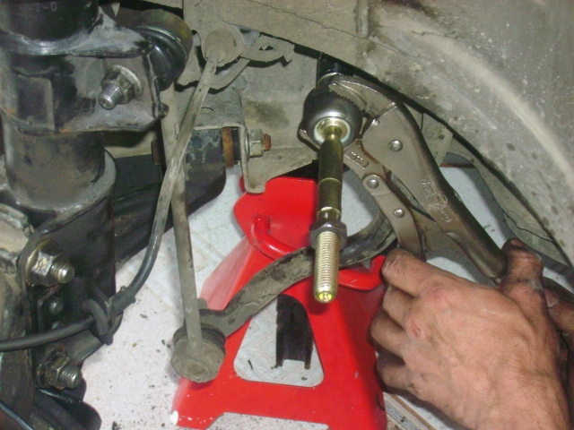

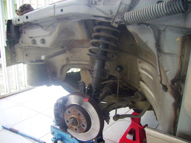

The history here is not so far than in the US... A TOYOTA is the responsable for this TRAGEDY!! I'm almost done with the repair in my car (only the mechanical part is done), I'm waiting for the bodywork is finished to assembly again the car and take it to the "measure bank" (i don't know the exact word in english) to see if the chassis was twisted or not... I'm praying for that it is not my case!...MadeInJapan wrote:In the U.S., we would call that car totaled.
Good luck with the repairs- guess things work a little differently down there in Costa Rica.

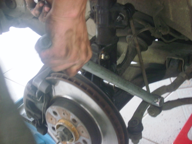

More photos...

Nice job on that suspension repair.
Suggestion: start a new thread with the question about your dad's car. It's a good question, but will be missed if it's buried in the discussion here.

Thanks Chuck, what more do you think I need to look at it?chuckcintron wrote:Nice job on that suspension repair.
