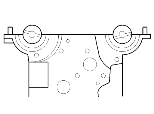

there should be no reason to resurface the cam case and top of the head. actually do not do it. the cams do not have bearings just the machined surface of head and cam case. any machine shop can check the head for warpage and cracks, with cvvt you really should have the cam alignment tools older 850's etc i dont bother with the tool. ive got a pic of the cam alignment ill try and post it, its from the drivers side/back side of cams where the special tool would go

sorry theyre both the same picture, not too swift at this photo stuff

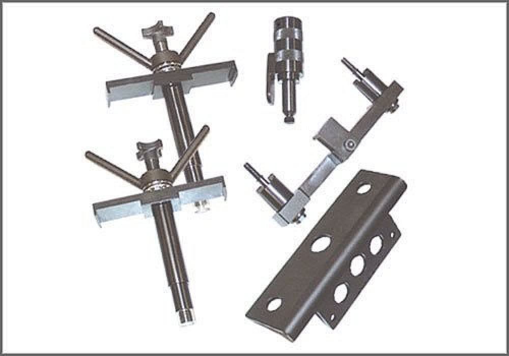

Ariete57; Do you know if the special tool you bought for the '95 850 turbo is the same one used on the '02 V70?
Could be possible to post a picture of this tool?

the tool is the same for all of the cams
http://s261.photobucket.com/albums/ii69 ... mtools.jpg
http://i261.photobucket.com/albums/ii69 ... mtools.jpg
the cam tool is the one on the right in the middle
this is not the best picture ill snap one tomorrow at work
the ends of the tool are keyed to fit in the end of the cams, it would be possible to not use the tool and mark the front of the gear and the rear of the cams etc. but its not worth the hassle and possible bad outcome.

cucuracha, did you make these or buy them?
I know that bought they are damn expensive.

oh no sir,
these are pics i pulled from alldata, i work at a volvo dealer so i can get a nice pic of the keyway. i wish i could find just the locking tool for sale, all i find is this kit and like you said $$$
