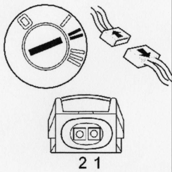

Check all the earth contacts around the MAF and IAT and check the terminal contacts for corrosion/oxidization. Also, whilst you are busy at the plug test for voltage between terminal 1 and earth. Switch ignition on, disconnect the plug and connect a voltmeter between terminal 1 and earth. Reading should be approximately 5 volts.
IAT plug.jpg (36.99 KiB) Viewed 300 times
I thought I'd better show which is terminal 1.
