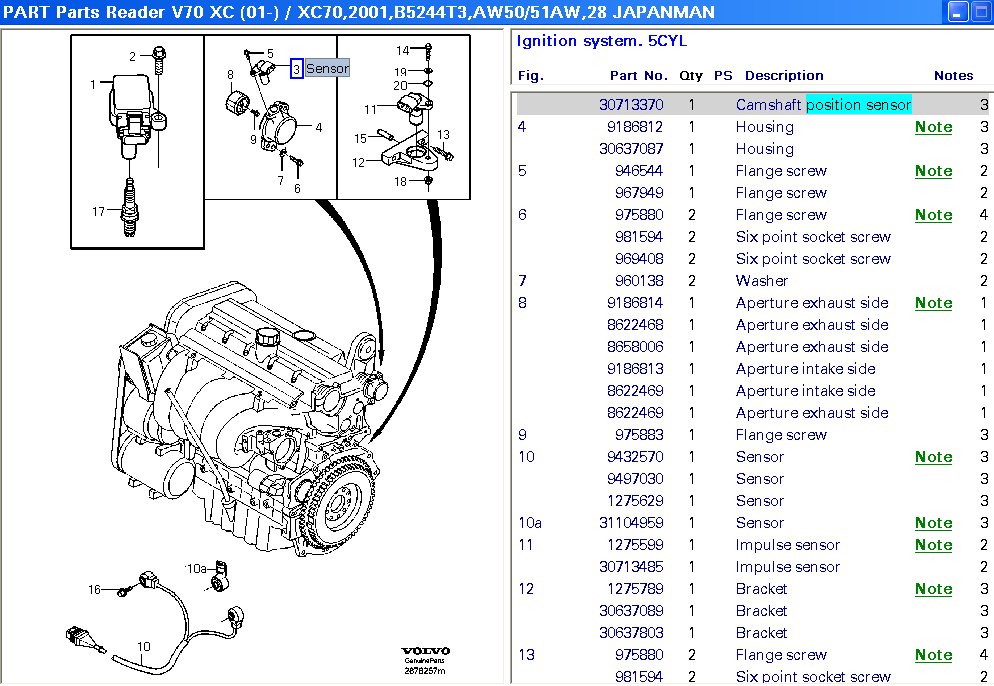

I'm suspecting that maybe the cam position sensor has gone bad- the cause of your first codes as well...may have been on the way out...but now it's not getting a signal- this will cause your no-start condition: It might not be this, but you've seen where I've highlighted #3 (labeled "Sensor"). This is attached right at the rear camshaft seal. If the seal leaks oil and it gets on the sensor, it could cause a malfunction....Your ignition control uses this as a speed sensor and if it is wet with oil or the cable connector to it is corroded, you'll have a no-start condition and even misfire codes if it's getting a partial signal. This is not that hard to take loose to check. Just check it and if this isn't it, we can at least eliminate this from the puzzle.

I snuk to my shop and there is no sensor in that location on my car. That is exactly where my upper motor mount is located. Unless its under that mount. I just don't think that cam sensor could be there.

VADIS says it is for your car, and I think it's below your motor mount...as you speculate.
