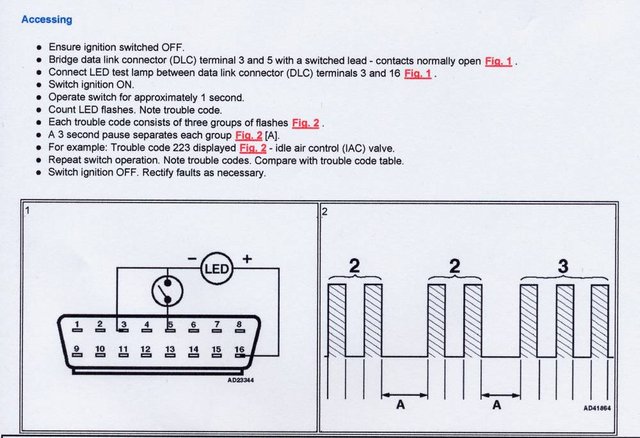

Someone experimented with this sometime ago and Bill found and posted this diagram up.
If you look around (search) MVS, you will probably find some other information about making your own scan tool. What you get is the diagnostic box functionality that is under the hood for earlier model year Volvo's....this was taken so far, however, no one was able to read all of the codes or reset the service light. Have at it and see if you can figure this out- if you do, you're gonna be popular here!
