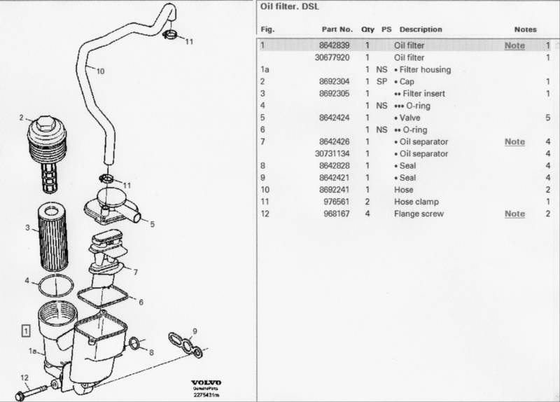

It is quite straightforward, for a Volvo using basic tools.
The engine should be at normal operating temperature.
Remove the lower splashguard and place a container under the sump.
Remove the drain plug and allow all the old oil to drain out.
Reinstall the drain plug using a new sealing washer. Tighten to 35nm.
Replace the splashguard.
Remove the oil filter housing cover and the filter insert.
Remove the filter insert from the housing.
Remove the O-ring.
Clean the housing.
Lubricate and install a new O-ring.
Install a new filter insert in the housing.
Screw the housing and filter into place.
Tighten to 25nm.
Fill with new engine oil - start with 6 litres.
Start the engine and check for leaks.
Stop the engine and allow the oil to drain into the sump. Check the level and top up if necessary.
The attachment illustrates the filter to make it easier.

So i need :
A Seal Washer for the drain plug
The Filter
and the Filter O Ring
Do you know if these items come as part of a service kit ?
Otherwise i will hunt my car accessories shop for them

John,
They are all separate, at least in the U.S...don't know about where you are. www.fcpgroton.com www.myswedishparts.com and eeuroparts.com come to mind over here- they will probably be too expensive once you pay duty for where you are.
-MIJ
-MIJ
