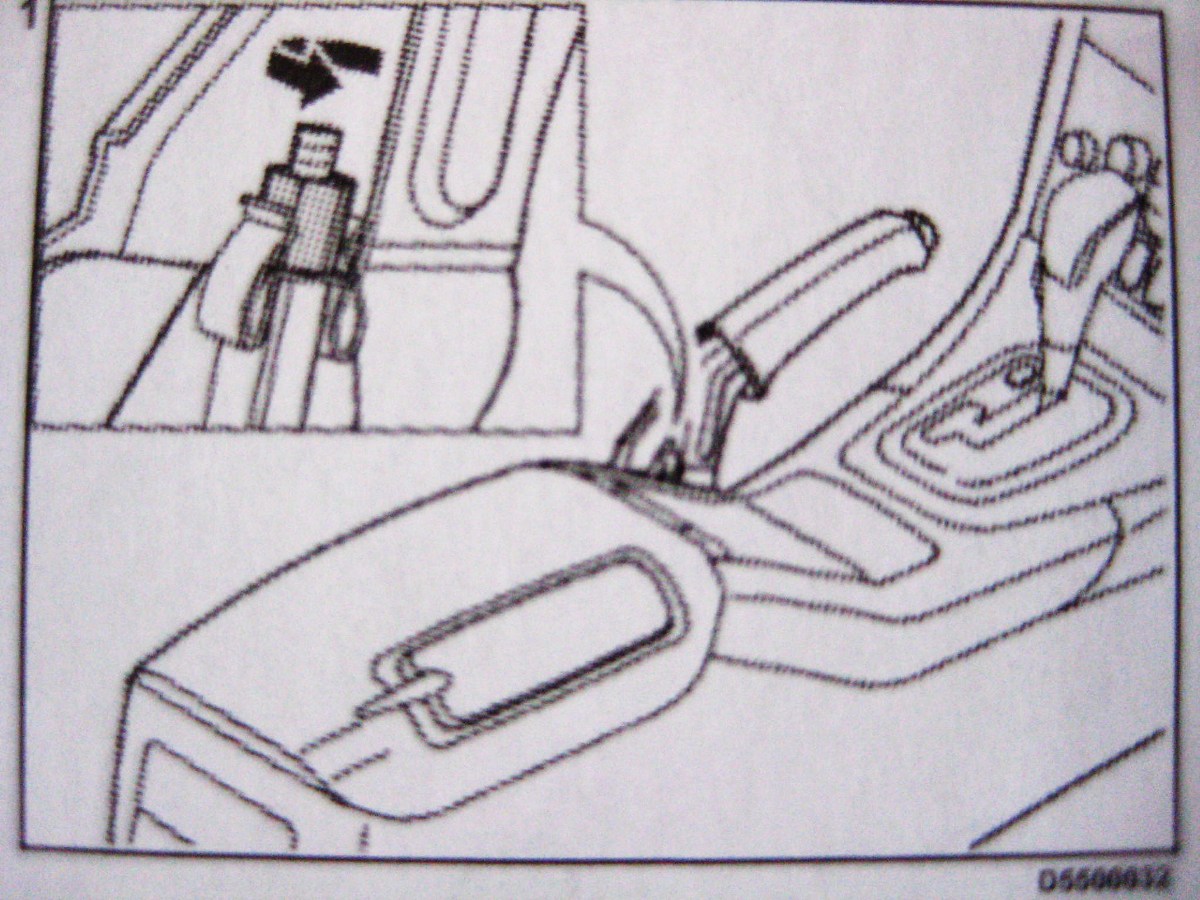

Here are some pics and notes which show the procedure I used to complete the job.
1. Undo the cover on the parking brake lever
2. Undo the nut for adjusting the parking so the parking brake lead slackens. This will reduce pressure on the caliper piston.

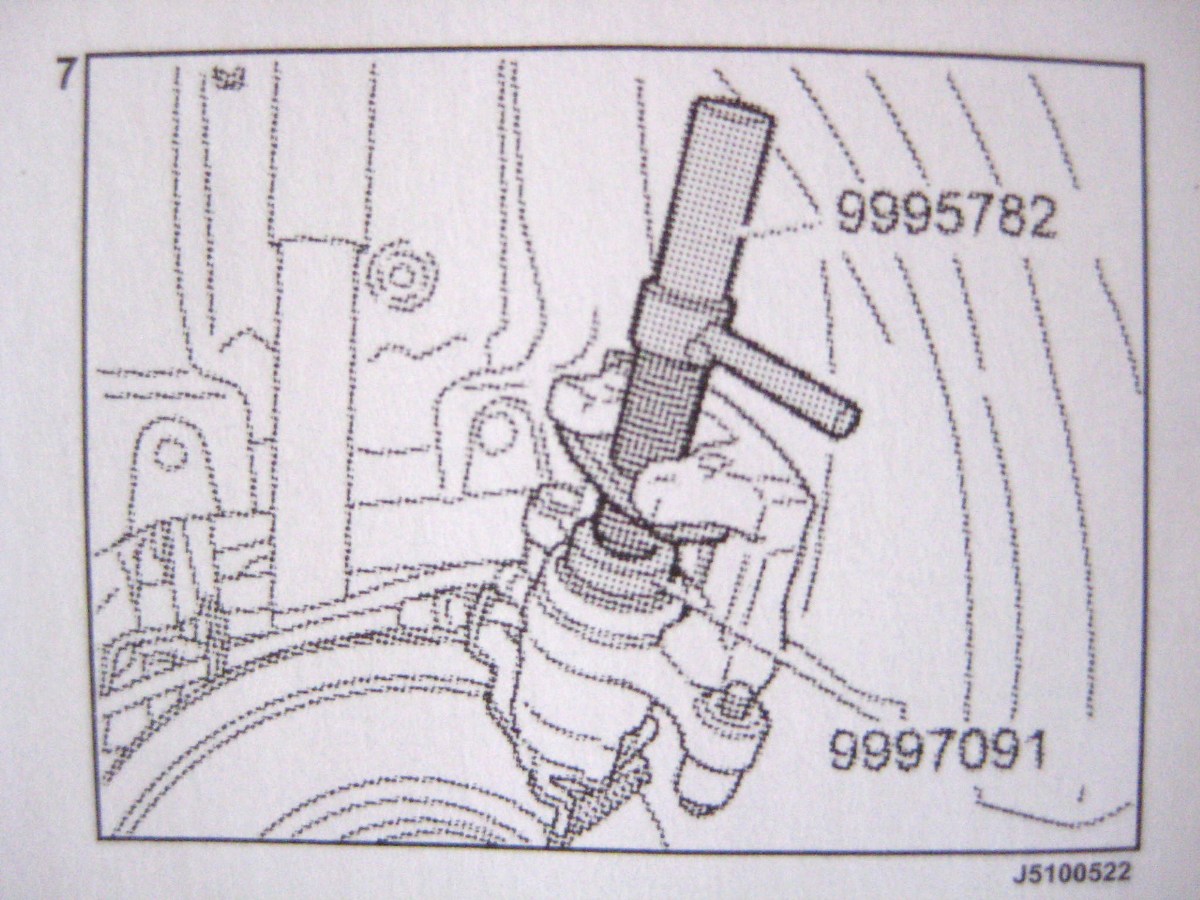

Here is a pic of the tool volvo uses to compress the caliper piston. Probably unavailable to the average DIY'er
Here is the pic of the tool I used to compress the piston. It just so happens that I had a wrench which fit my Makita hand grinder to change the grinding wheel and it fit perfectly to align with the holes in the top of the caliper piston. I used a downward pressure (and I mean alot) while turning clockwise to retract the piston. I also doublechecked on volvospeed forum and volvo forums they confirm the same process. I know I was lucky and had a tool that worked. I also think that one could make a wrench by taking a strip of heavy flat stock and drill two holes the same distance as the recessed holes in the piston. Then take two small 1/2" to 3/4" long by 1/8" diam. bolts and put nuts on them leaving enough of the bolt extending out to fit into the hole. This should help all the DIY'ers to get by without having to go to the dealer and drop a wad of cash for the fix.
