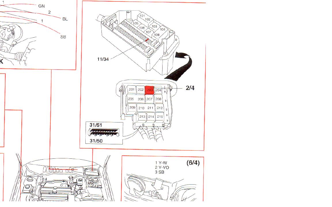

Any suggestions? Could i have hooked up something wrong in the many connections that i touched removing the intake manifold? It doesnt seem that i would have touched anything related to the washer / squirter system and this may just be a coincidance. Where is the ww relay?

It's the one marked in red (203) In this diagram:

There's a wire running to the washer fluid pump, which is in the tank down inside the front fender. Maybe you disturbed that wire when you worked on the intake. It sounds like the relay is stuck/welded shut. Maybe you created a short in one of the wires. I'd take the relay out and tap it a few times, then reinstall it. Check over the wiring in the area you were working, then try the wipers again and see what happens.bobd324 wrote: Any suggestions? Could i have hooked up something wrong in the many connections that i touched removing the intake manifold? It doesnt seem that i would have touched anything related to the washer / squirter system and this may just be a coincidance. Where is the ww relay?

No. Look on the backside (closest to the firewall) of the fuse/relay box in the engine compartment.bobd324 wrote:is this relay inside the pasenger compartment above the drivers feet?

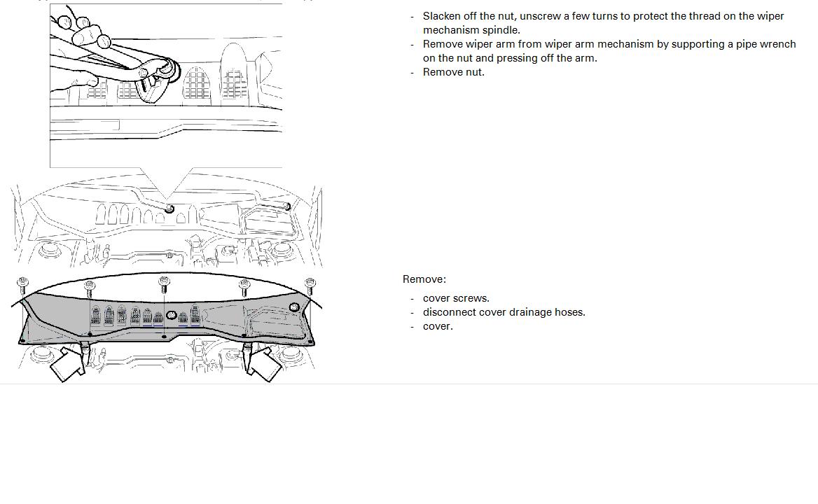

I believe those relays are on the back side of the fuse box in your car.
Here are some VADIS directions on how to remove it. Maybe OzarkLee, MIJ, or Billofdurham will jump in here with some tips. I think there's a connector at the bottom of the box, also. I would try to just get at the relays without removing the box.
