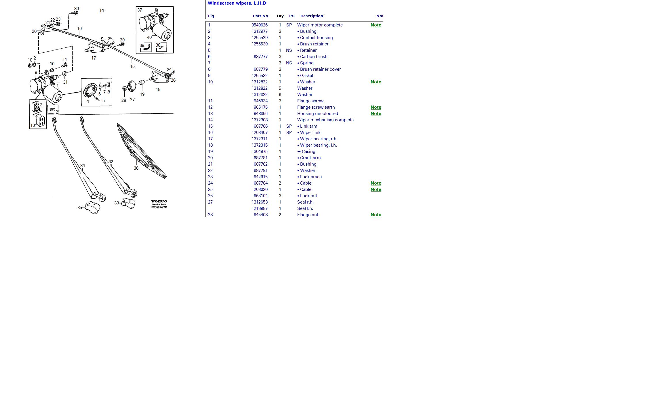

I bought a 1988 240 GL in fantastic shape for a fantastic price. Some problems have emerged: the manual sunroof, which was a major selling point, is now "missing" when the winding crank is turned. Does this have teeth that may need to be replaced? On first starting, and putting the car into gear, sometimes it dies. The radio works for a little while, and then suddenly will begin "howling" so I have to turn it off. The windshield wiper motor was replaced, and they worked great until something in the dash came loose and began to jump around frantically. I pulled the glove box, but I cannot tell what should be hooked to what. Any ideas on what I should be doing to repair my Volvo?

Here's a diagram of what should be hooked to what:FLOWERPOWER wrote:The windshield wiper motor was replaced, and they worked great until something in the dash came loose and began to jump around frantically. I pulled the glove box, but I cannot tell what should be hooked to what.
