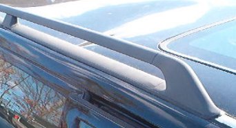

Sure. In fact you probably should go OEM. The 850 up through 2000n V70 will bolt right on.peffley wrote: Can you even get the Volvo OEM Rails? This would be nice for looks and I could tackle my peeling black / chrome strip up there at the same time I installed factory Rails / Racks (assuming that is where they would be mounted).
Volvo cross bars, OEM and other aftermarket goodies will work with them.
There are already threaded inserts under that wasted black strip of yours on the roof. Easy, breezy!
Volvo made a thin (and much more attractive, IMHO) rail for the earlier wagons, and then started using a fatter rail on the XC 70's. They'll both work.
Search eBay for "Volvo Roof" and you'll usually find a few sets around.
