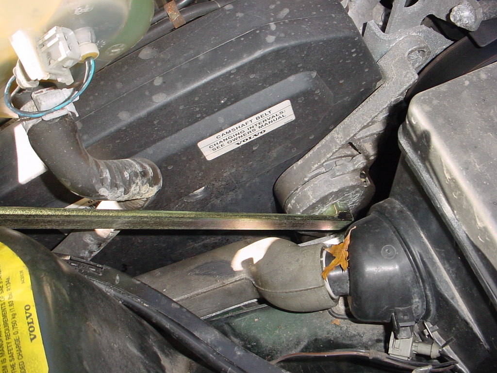

I am attempting to replace the alternator but I have a hard time figuring out how to get the belt off. I see the wheel that controls the belt tension but
I do not see any tension controllers.
Any advice is appreciated! :)

The tensioner looks like an idler wheel and, at least on my 850s it is directly next to and slightly below the alternator. It takes an odd sized (3/4" give or take) square socket to release the tension or others have just used a small pry bar. It does have a hole in a dog ear to lock it in the released position once you get it released to make putting the belt back on easier.
I have a tool that I bought from IPD but here is what you are looking for.

the tensioner for your serpentine belt is just about directly to the left of the alternator, there is a nut right in the center of it, I don't remember what size, 12 or 13 mm I think, put a wrench on it and turn it clockwise as far as it will go to remove the tension (if you can't see the nut, it may still have a plastic cover on it that you can pry off with a screw driver)
