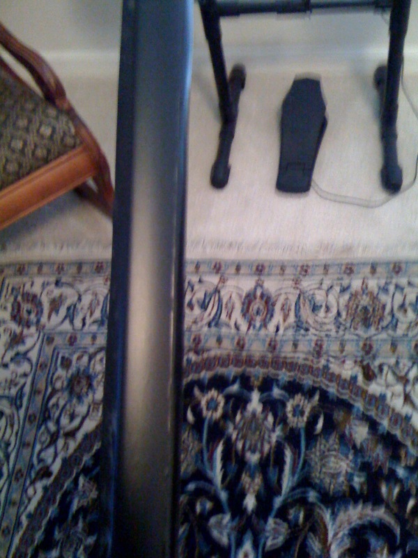

I'm in the process of doing mine also. Finished up the drivers side yesterday and will do passenger side this weekend.
The 'inside' lip is easier to tape because it actually wraps around and under the metal strip and there is a little spacing between the metal and the rubber strip. The 'outside' (or closest to the doors and windows) of the trim strip is harder to make look good because rubber meets the metal with no lip.
The completed strip did looks much better than it did when it was mostly all peeled off, but on close inspection the tape line isn't as straight as I would like. I'll be more careful in cutting off the old covering on the 2nd rail. I'll also probably end up re-doing the drivers side.
FWIW the dealer quoted me $150 each for the rails and $100 to install. The tape cost me $5.95.
