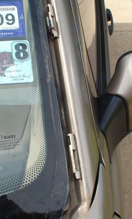

Volvo roof trim clip 1.jpg (357.17 KiB) Viewed 3469 times
This is what the roof channel and trim strip clips look like.

There was another thread on this earlier somewhere. Start at the windshield area. Get your fingernails then fingers under the strip. Carefully lift with even pressure on both sides, taking care not to bend the trim strip. After the first clip pops out, slide your fingers up to the next clip area and again pull up carefully. Continue up along the roof to the back.
They are replaced the same way, just fit the trim strip into the clips and 'pop' them back in.
Roof trim strip clips.jpg (72.82 KiB) Viewed 3468 times
This might help show what is under the trim strips.
