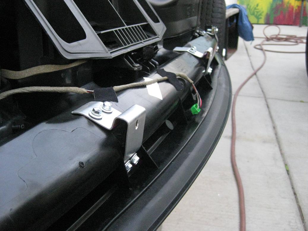

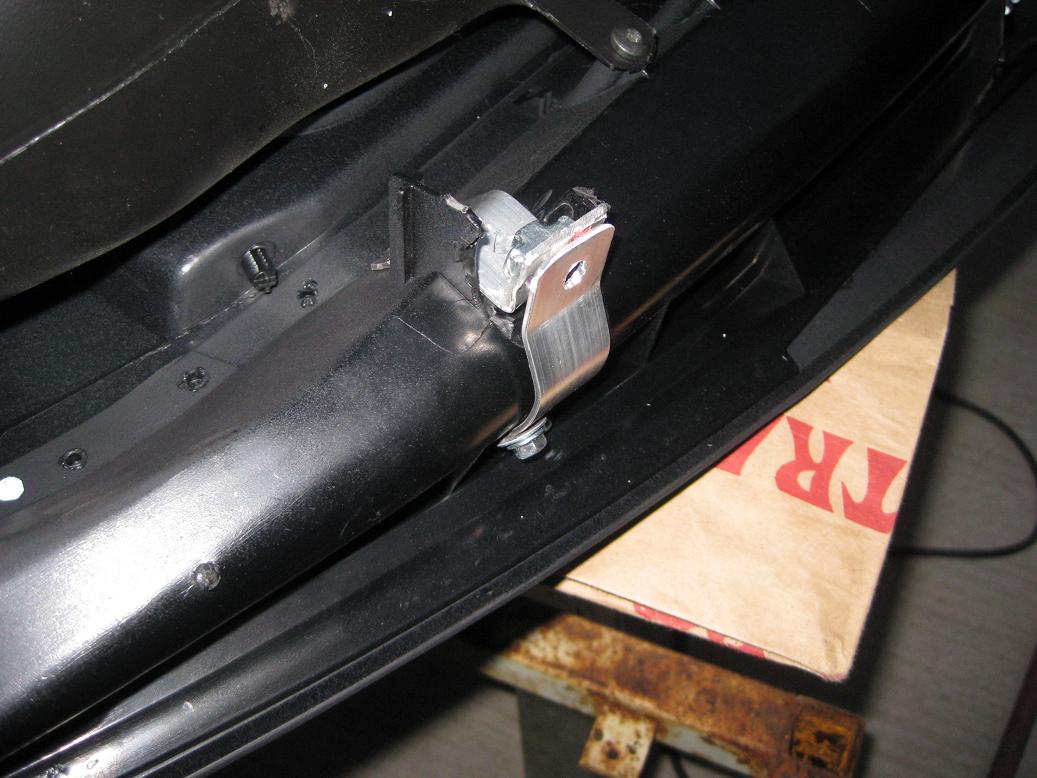

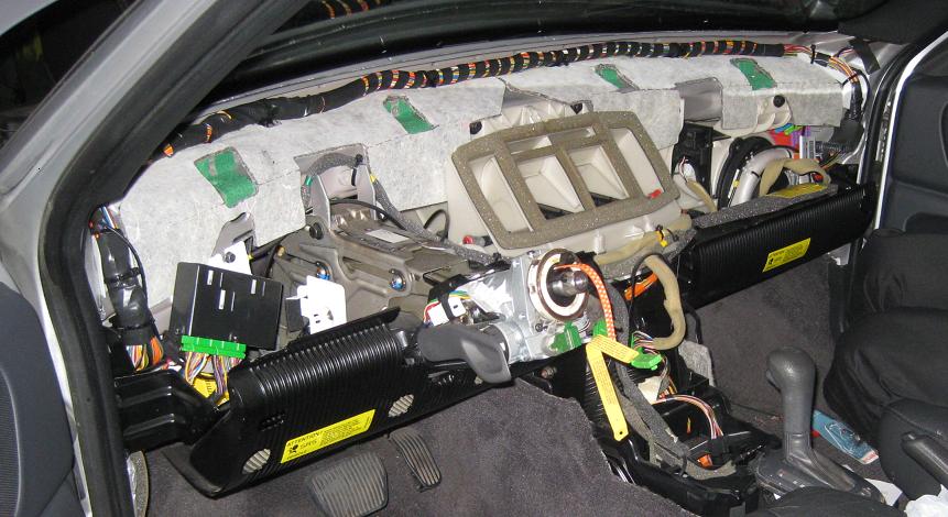

This repair was much easier than I expected, and the results are incredibly satisfying. Having a squeak-free and crunch-free car back is nearly priceless.
The worst part was fashioning the new mounts from .0625" Aluminum bar, 1.5" wide for the middle two and 1" wide for the ends. I should have used thinner material - it would have been easier to bend.
With proper preparation and a cleared slate this repair can be done in one day, easy.
I used #12 1" self-drilling screws with rubber washers through clearance holes in the aluminum.
The end mounts were a bit tricky to fashion (not parallel where the Al meets the defrost vent) in one piece, so I used two and put the nut behind both - the bolts are long enough to engage even with the extra distance to go.
The mid mounts were easy by comparison.
I used a 4.5" angle grinder to grind the old mounts off so that the new Al was at the right plane.
Green adhesive-backed felt was used to ensure squeaklessness.
Check out the pictures.
Thanks to those who have gone before and written about it!
