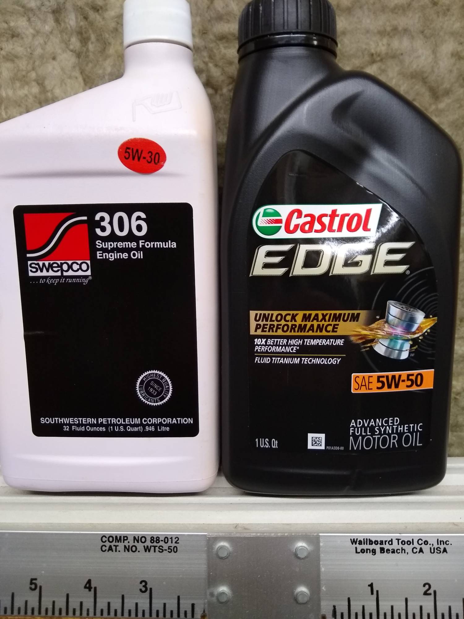

Kirkland does not have a 0W or 5W40 oil. I am currently experimenting with their 15W-40 due to a prior sale purchase. Caveat is adding Swepco 5W30 as an additive package for winter as it has high TBN numbers, ZDDP and Boron for extra protection.kallekula wrote: 03 Oct 2022, 05:39 I’ve seen their Kirkland oil but I haven’t tried it yet. I used Oreillys own oil last time I changed oil on my S70,

On sheetrock and Rock Wool back drop

Wow, a little hand-placed sticker with the oil weight does NOT give much confidence ...
