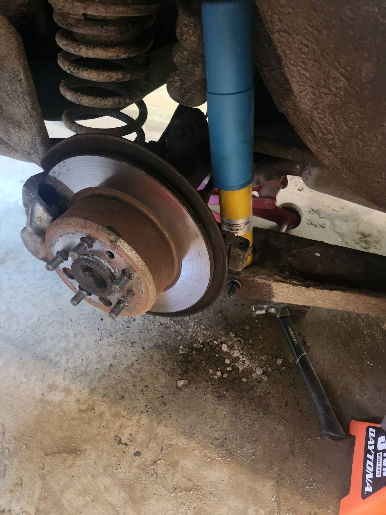

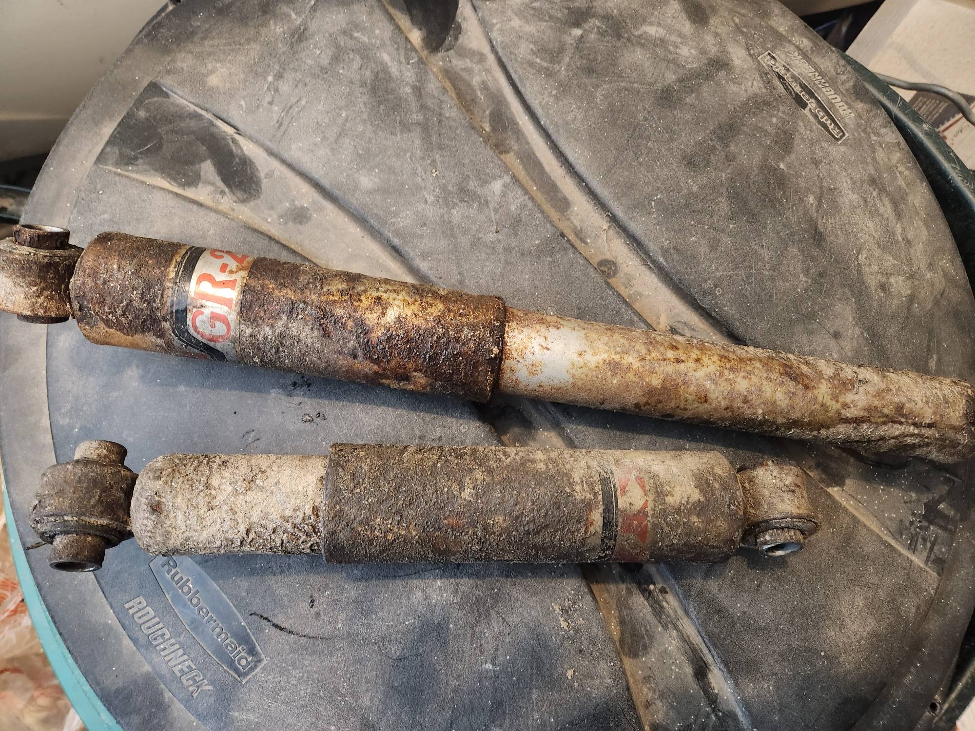

We did have enough time to swap the shocks. What a difference. The old ones were from 1998 and 111.5k, which by our best guess was about 80k or so ago. The one on the right was so weak it had next to zero resistance. The one on the left had some rebound but was very worn also. I anticipated the hardware would be rough and I might even need to get out the torch, so I ordered new lower bolts and nut as well as nuts for the top mounting stud. They actually were in OK shape, but since I had the new ones on hand we put them in.
The new Bilstein B6s make a significant difference, especially paired with the IPD +300 springs, and for that matter would have made a significant improvement over the stock springs and cheapo KYB shocks when they were new.

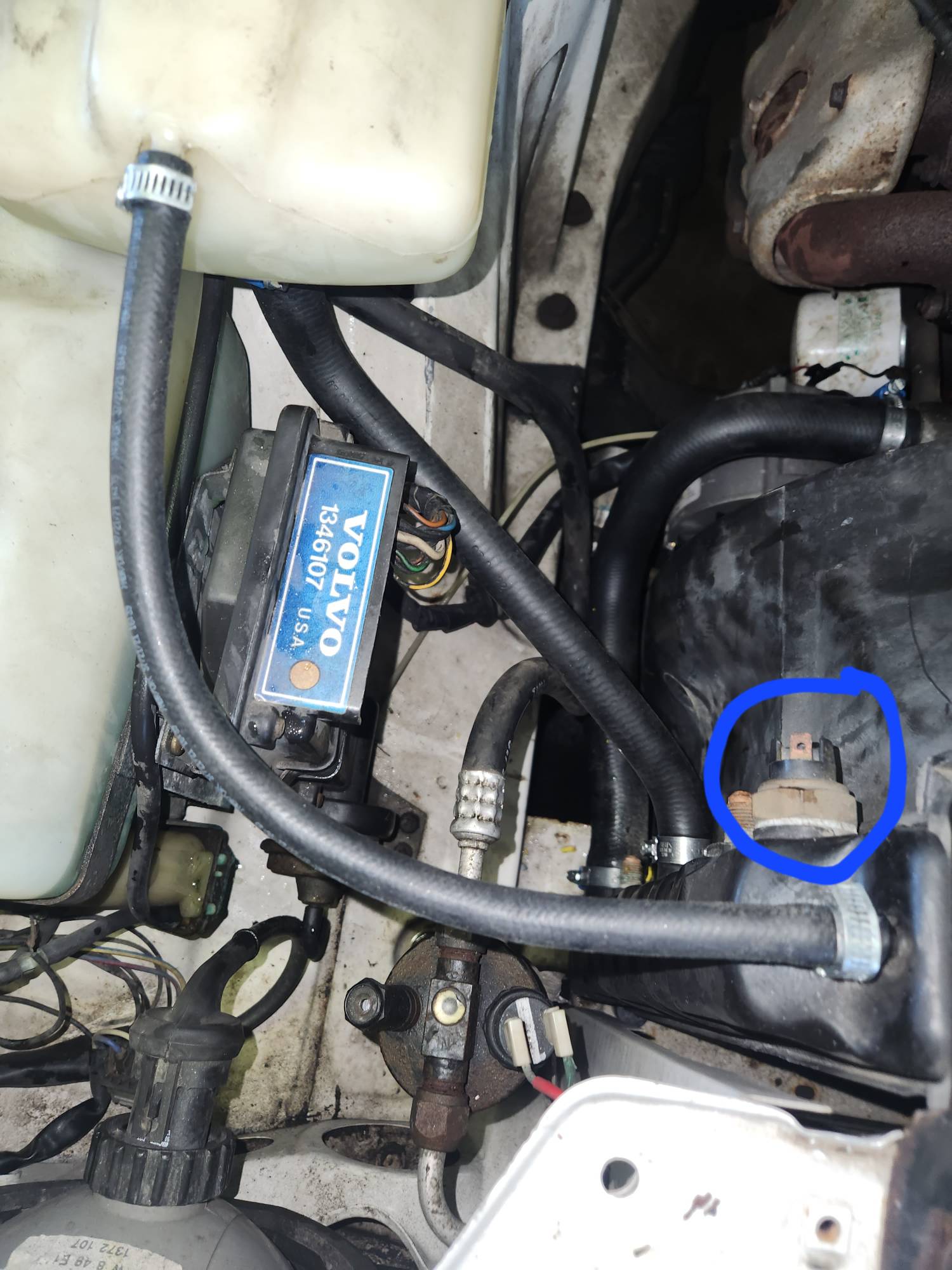

Here's a question for the smart folks. What is this sensor? I don't think it is coolant sensor, because it's not connected and we have engine temp indications.

I do not remember ever seeing a sensor in that location. Perhaps it is a coolant LEVEL sensor.
