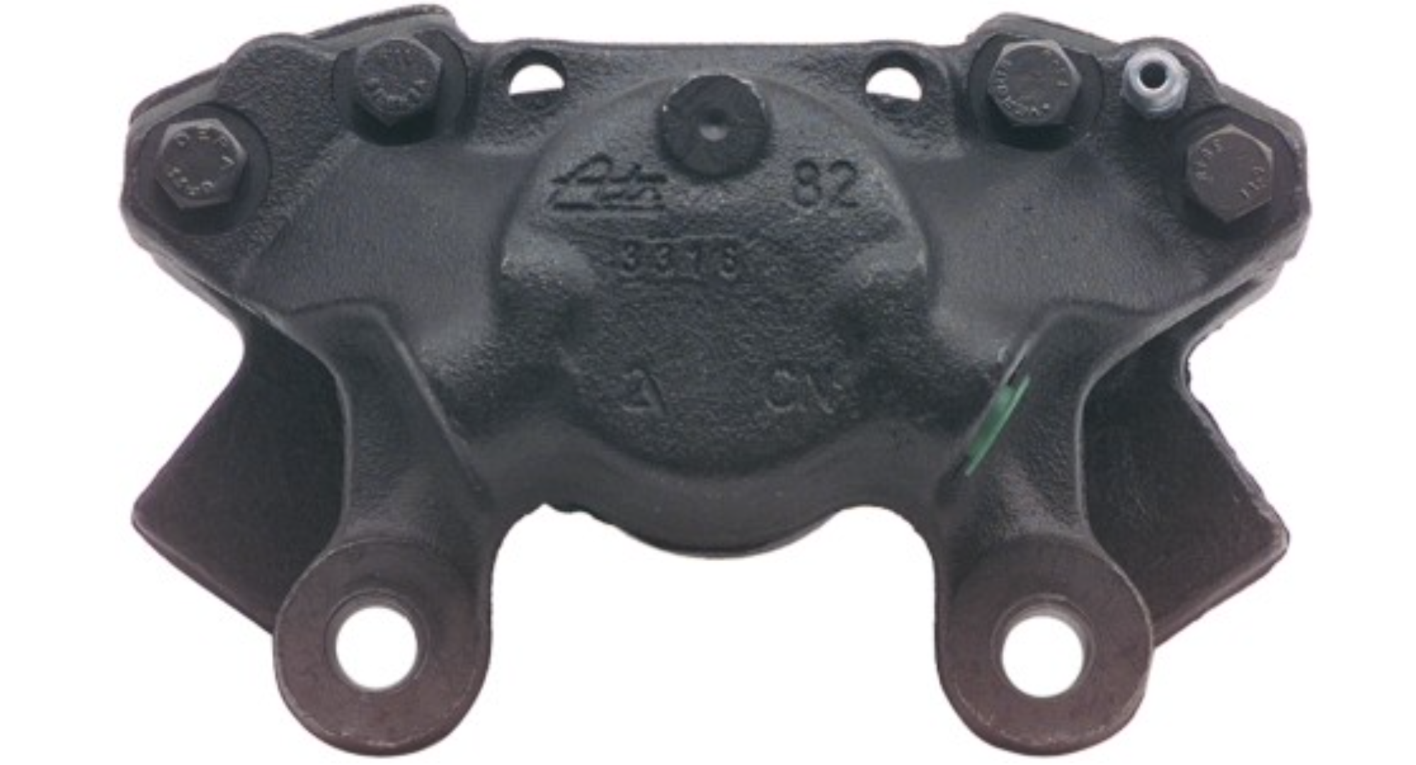

This has been posted about extensively the last few years but to recap here:
Factory P80 calipers have nearly immortal (!) stainless steel slide pins. On even the most rusted, shot factory calipers the slide pins are usually fine, probably could use a de-greasing and light sanding (and re-greasing with e.g. SIL-glyde).
On the other hand, rebuilt calipers all come with shiny, brand new, pot metal slide pins that quickly corrode and will soon cause the calipers to stick, probably before the caliper has any sticky piston issues.
Test with a magnet: stainless slide pins are non-magnetic, the junk ones are magnetic.
And from any crusty old factory caliper you come across, save the slide pins!

I just popped a new set of ATE 604033 pads into my old ATE rear calipers. The boots on the pistons are definitely past their prime... loose, gooey rubber that has some breaks and splits in it similar to the photos above. I was able to press the pistons all the way back into the calipers, so they're not frozen yet but I'm going to replace the calipers... checking out the NAPA adaptive one rebuilt front ATE calipers you linked earlier, it looks like the rear calipers are available for about $80. Have you tried/tested the Napa adaptive one rear calipers? If so, what's your experience/opinion please?

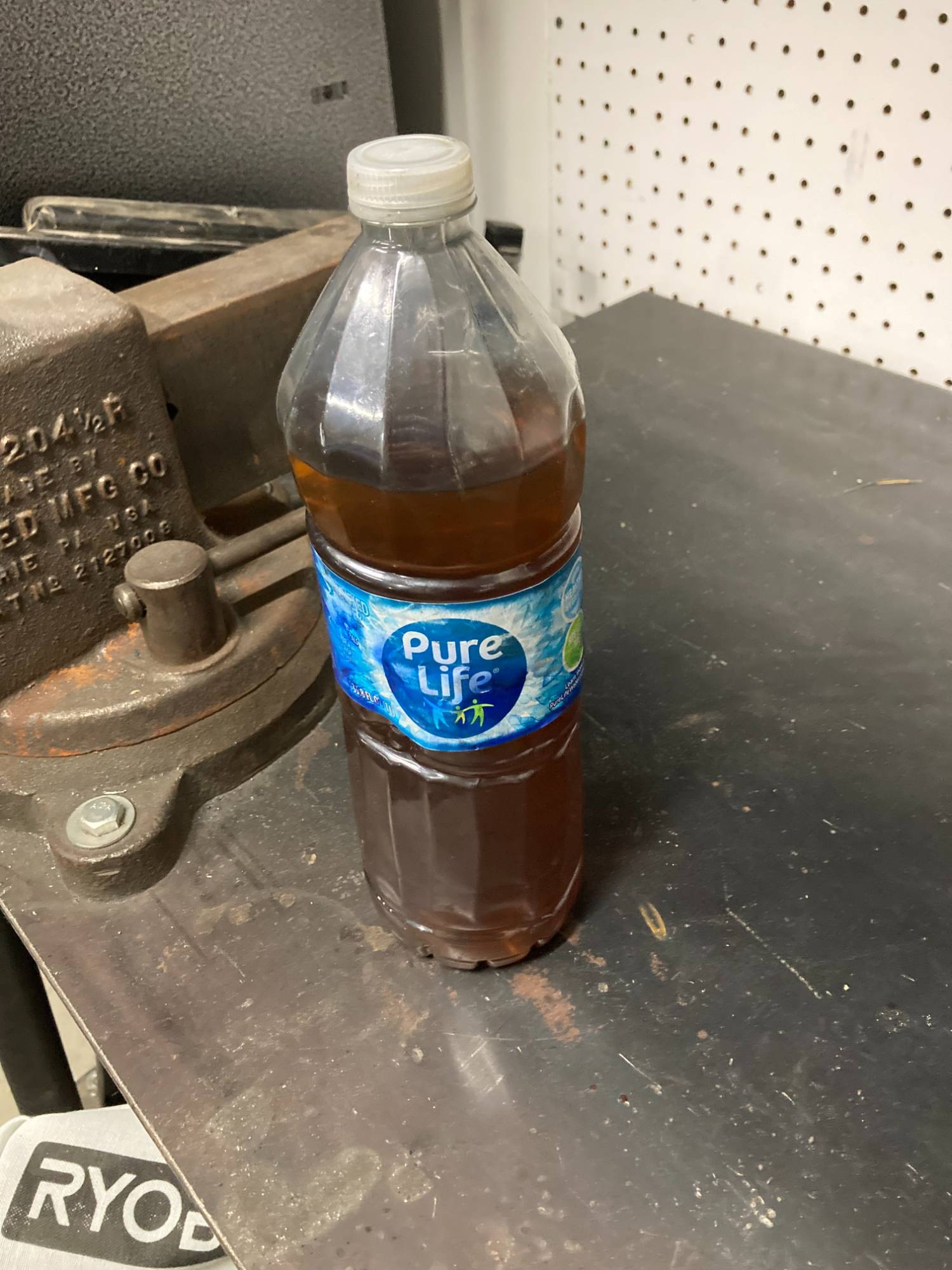

Were you able to move the brake line nut? I tried, but it started stripping so I backed off. Originally I planned on doing the calipers at the same time.
BTW last time I touched the brakes was in 2007. Here is the brake fluid (not sure why it's sideways, sorry):

Ooof, that’s nasty looking. Volvo says replace every 3years/30k miles

Yeah, I'm sure. When bleeding all sorts of nasty boogers came out. Doing it every few years would also help exercise the bleed screw and ensure it doesn't weld into the caliper.abscate wrote: 05 Jun 2023, 03:19 Ooof, that’s nasty looking. Volvo says replace every 3years/30k miles
I tried using a vacuum pump to suck it out but gave up, making it a two man job. Wife helped.
