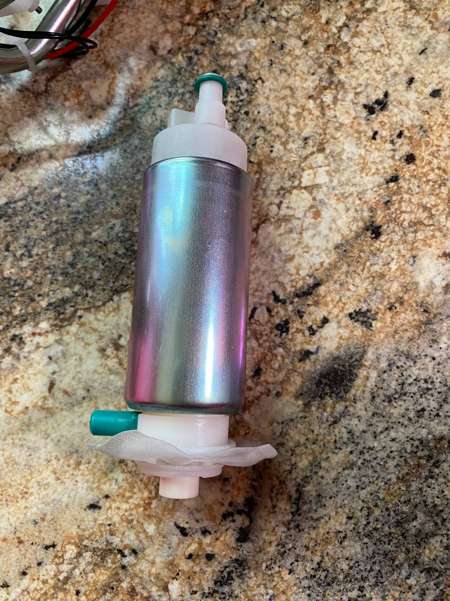

In regards to the fuel pump:
I took one of the old PPS units apart to verify the manufacturer of the pump motor itself. I had a feeling it wasn't a genuine Walbro unit, and sure enough it isn't. You can see in the pictures, but it's an unmarked Walbro GRJ235 knock off. I imagine the bearings are made of cheddar cheese or something similar. If anybody has an OEM Volvo pump they'd be willing to sell me, I'd love you forever.
A real Walbro pump would be stamped with the name and model. So, lesson thoroughly learned with Pro Parts Sweden.
