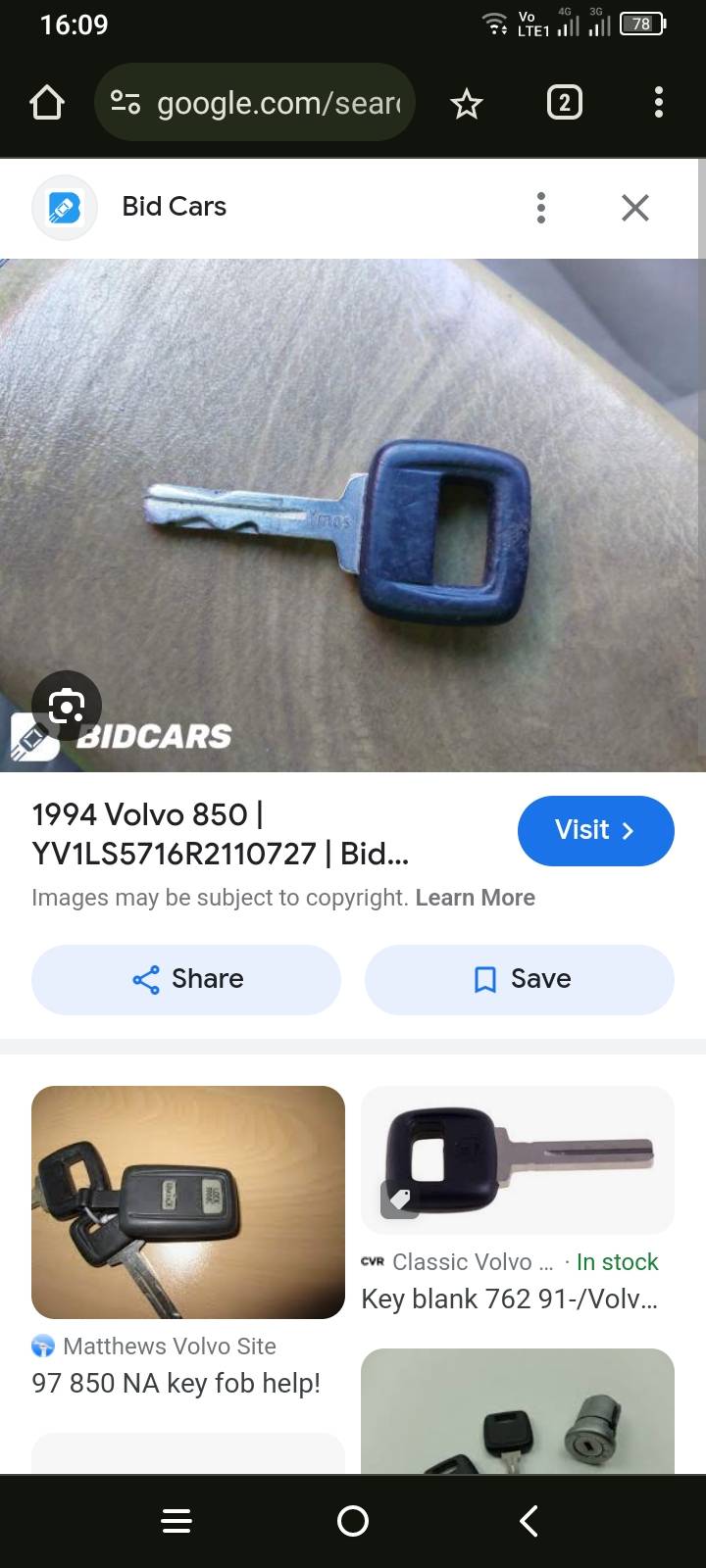

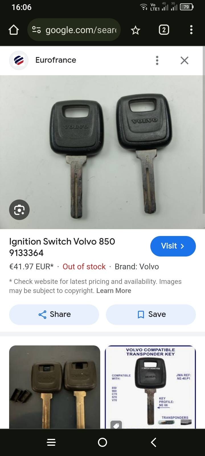

This is how a chipped key for 850 & s,v,c,xc70 looks:
This is non-chipped key for 850:

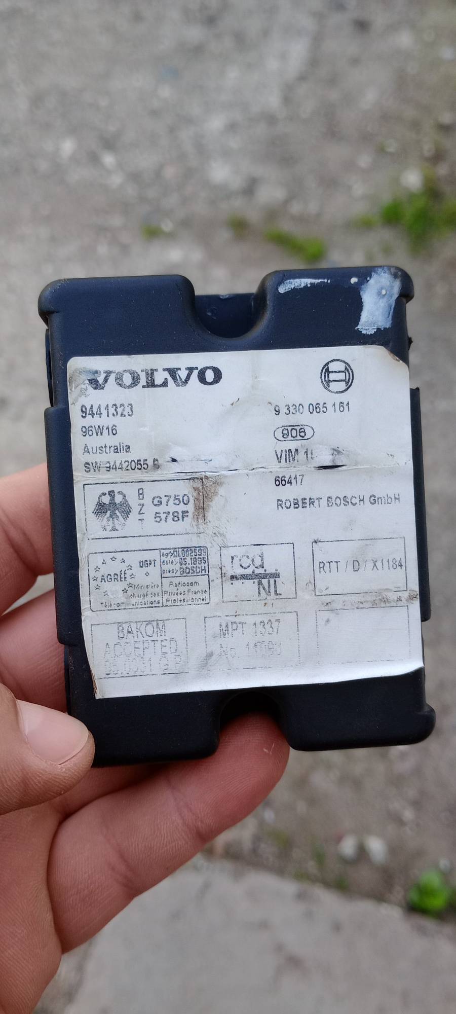

Here is the picture of my old one which have a fault:
The only numbers which are different on a replacement which is now in the car is the one below main part # 96W16.
I guess that should be a key id.

Okay thanks. Though i have exact same P/N and Software on mine so i am now confused what they done there and or check those led outputs are they active on mine and i just missing a wire here.misha wrote: 13 May 2024, 11:56 Here is the picture of my old one which have a fault:
That 96W16 on label is 1996 year and Week 16. These boxes does not have coded Engine MIN code so can replace them without problems.
There was some footnote about Led configuration on some countries which insurance required led always but i dont have in memory at all details of about it how it did differ.
