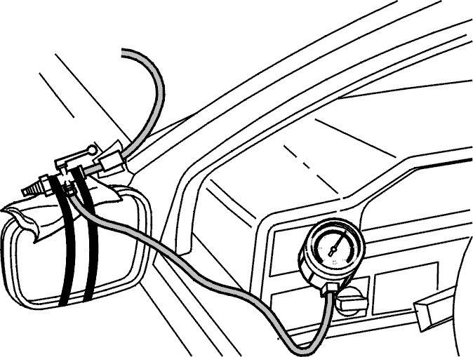

I spent 90 minutes with vida, very unintuitive software, it shows a pressure gauge used at the fuel rail because mine doesn't use on demand PEM or pressure sensor on the rail. I couldn't find pump duty cycle and it doesn't allow pump actuation from vida, but then you only need to turn the ig key to do that.
I was able to roll windows up and down so I know I was connected.
best bet is old fashioned pressure gauge.

That is a bummer. I will look into a physical pressure gauge, but while that will allow me to see some pressure drop while the car is off, I won't be able to see if the pressure drops in full load.

To watch fuel pressure while driving, I have run a fuel pressure line from the end of the fuel rail out the corner of the hood to view from the drivers seat. You can remove the internal check valve from the Schrader valve to get flow to the remote gauge.

Vida shows testing fuel pressure for my car with no PEM by running the hose for the gauge into the car through the window.

Definitely heard of the old-school method of running the pressure gauge into the car - interesting that it's actually in the manual as the "correct" way to do this!
