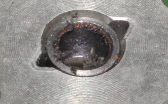

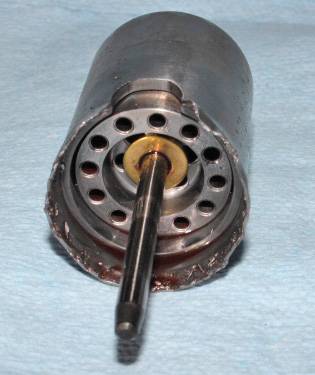

Found some photos of the sticking solenoid with my 2001. I read some time ago they traced the problem to a coating they put on the bushings (I think PTFE coating). The coating would swell and cause the plunger shaft to bind. Ironically, I suspect they added the coating to make sure the shaft moved freely.
Under the copper (bronze?) washer on the shaft is one of the two shaft bushings.
I scraped away some of the coating just to confirm there was a coating on the bushing.
