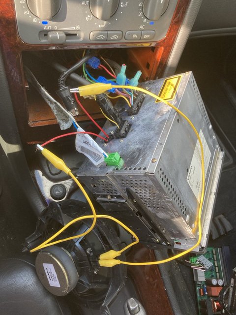

- I then proceeded to do the same directly on the back of the radio (see image below), to determine if the cable could be the problem. Still I did not get any sound at the test loudspeaker.

Today I gave it another try. I took out part of the central panel and found out that there was installed some kind of system to turn of all loudspeaker when getting a call on the phone, except for the two front ones that would be use on the call. I assume we would be talking about a physical phone on the car, which used to bu common in Germany and would explain three holes I saw on the passenger side of the central panel (phone were usually attached that way).scot850 wrote: 25 Mar 2025, 16:45 I would suggest trying to find any cheap Volvo radio SC-805 or SC-815/6 models. Anything with an inbuilt amplifier.
Does your car still have the original connectors undamaged for a radio without an amplifier? They are usually connected behind the radio and covered with foam to stop them rattling. If you do have those connectors undamaged, disconnect the add on harness for the amplifier and see if a more base head unit runs the speakers. If it does not, it is possible someone has some how damaged all the speakers. They do fail with age, but it is not normal for all to fail.
Never mind; I uninstalled the system an reconnected the wires that were cut during the installation. Theoretically now everything is connected as it should, but I still get no sound on the loudspeakers, except for the one on the dash.
I noticed the original connectors for non-Dolby head unit, wrapped in foam as you mention, are actually in use and not free as I expected. The loom connected to the big plug goes somewhere towards the foot well, but the one connected to the smaller plug is connected to something near the steering wheel (last picture bellow). I could not see what it is and could only take a pretty bad photo. Someone mentioned to my that it may be the Dolby Processor, but that they are unlikely to go bad (which in my case it usually is a tell-tail sign of the problem; I always seem to get the weird cases).
Here some pictures I took today.

Sorry, I can't access the photos. You can just disconnect the Dolby processor from the back of the head unit. That cable is just a signal in/out. Without it connected, the system will worked ignoring the center speaker and Dolby unit.

In your 4th picture that is the connections for the 2 cables that run to the amp. If you disconnect those the 2 other connectors to the rear of a lower end head unit, even the one without a CD player, you should then get sound to the speakers. That should hopefully remove that nightmare of cables. Unless you really want those things, I'd remove them all, protect the cable damage and try the unit again.
Now you mention the unit for cutting the sound for a phone, I believe that is why you get no speaker sound. When the phone systems cut the sound for the music, the sound only comes out the center speaker, that is why you are only getting center speaker sound. Removing that stuff I believe will restore your door and dash speakers.
