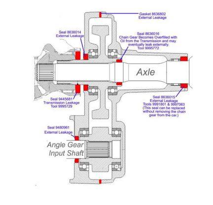

I might read the entire thread and the subposts. One example-
NO: 43-50
DATE: 05-10-2006
MODEL: XC90 T6
SUBJECT: XC90 T6 Chain Gear Leakage and Re-Sealing
DESCRIPTION:
XC90 T6 cars use a Chain Gear to transfer torque from the transmission to the angle gear. Oil leakage from the chain gear can be resolved by replacing seals and gaskets. The chain gear itself does not normally need to be replaced.
The majority of chain gear leaks are caused because the car has been disassembled for some other reason. The two chain gear seals which come into contact with the right front axle are easily damaged when the axle is removed and installed. The snap ring on the end of the axle can knock the spring off the seal and/or damage the seal lip. Whenever the axle is removed or installed for any reason (for example, when the transmission is being replaced) these two seals should be checked carefully and replaced if necessary. When installing the axle, insert it as straight as possible and be careful not to damage the two seals it passes through (8636015 &(NNN) NNN-NNNN.

edit- add photo, fix typos
NO: 43-50
DATE: 05-10-2006
MODEL: XC90 T6
DESCRIPTION:
