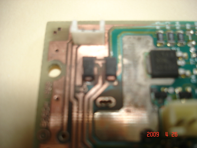

Excellent documentation, I followed your directions and it was exactly as you said. 2001 V70, who knew the siren could control the sunroof, of course mine quit just before a downpoor. I opened the module as you did and found exactly the same thing, I tried to go a little further by removing the transformer from the board and using some tarnish remover to clean the corrosion, in the pictures you can see where the copper was missing. I should have used the conductive product used to repair rear window defrosters to repair the connections but got sloppy and tried to solder jumpers around the breaks. I put the transformer on the wrong side of the board when reassembling and when trying to remove a second time pulled the leads out of the transformer. Moral, have patients if trying to repair the board. Now I'll never know if it would have worked. New unit installed, works fine. Thanks again
- copper missing where the circuit makes the corner at the edge of the bottom of the board
- DSC01005.JPG (123.75 KiB) Viewed 66716 times
- copper missing between top of T and bottom of T, top of board
- DSC01007.JPG (122.95 KiB) Viewed 66721 times
