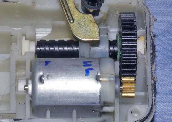

This problem sounds like interference from the motor in the door lock.
I recently had a problem with my door lock not locking all the time and replaced the lock assembly. I didn't get noise through the speakers but I did take apart the lock assembly and there is a motor that locks/unlocks the mechanism. If there is some problem with the motor it can cause interference and this is what you may be hearing through your speakers.
- V70 Rear Door Lock Assembly006.jpg (54.22 KiB) Viewed 1228 times

I think this may very well be the answer. I drove around a bit tonight with the radio off. The lock still malfunctioned, but there were no popping noises from the speakers. Guess I'll be ripping that door apart and replacing the actuator... (I hope it's easier than in the 850!) That is, unless I find any obvious wiring issues in the trunk at the REM. But, I think your diagnosis of a bad motor seems more likely... Just strange that only those two speakers would make noise...Doug S wrote:This problem sounds like interference from the motor in the door lock.
Thanks for the help guys, but I suppose it's about time I started to pull things apart
