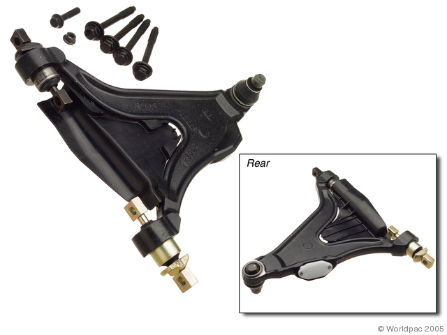

He has a 98 V70 AWD. I have the same car and it uses the four bolt control arm. I don't know if all the AWDs use the same control arm, but you need to check and see which type you have. This type has four bolts that come through from inboard the subframe and go into the control arm. This is from the fcp Groton site.
volvo 98 v70 awd control arm 4 bolts fcpgroton.jpg (139.38 KiB) Viewed 1695 times
This one is $139. To me, the bushing on this one doesn't look at all like the one in the link you sent for the febi/Bilheim bushing. fcp groton sells what looks like the same kit but it only fits the control arm with the 2 bolt mounting.
The subframe bushing is something different.
