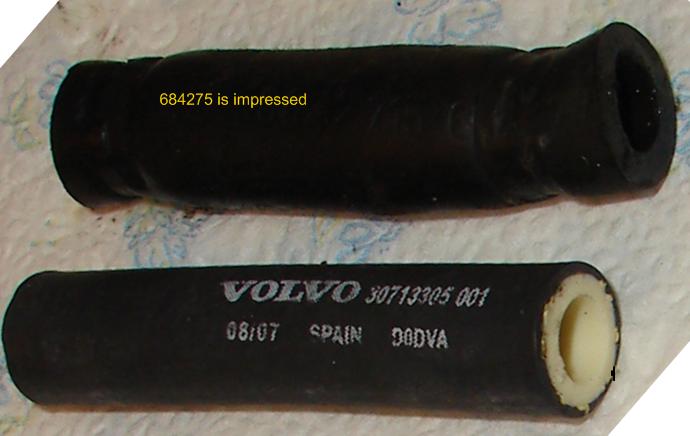

Hello all,
The new 30713305 hose came in today from FCP, and I pulled the old hose off. The old hose has an impression that reads 684275.
The hoses (see pic) are a good match as far as size goes - but the new 30713305 is a multi-ply, with a white material on the inside. The old 684275 is just a plain rubber hose.
Will install 30713305 (barring objections) and let you know the outcome.

If it fits on the lines it looks like they learned from their mistakes and beefed up the hose.

Just installed the new hose -- fits marvelously.
Thanks to everyone for guidance on this one.

Glad it fit! Now I know if mine goes.
