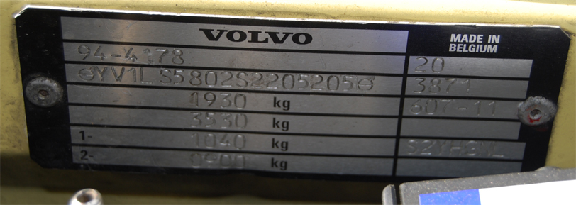

From https://www.volvo850t-5r.com/about-the- ... ification/:
yellow 850 sedan product plate
yellow 850 sedan product plate.jpeg (147.44 KiB) Viewed 332 times
Production colourcodes for the T-5R are:
607-11, 019-11, 421-41
607 = Cream Yellow
019 = Stone Black
421 = Dark Olive Pearl
11 = produced by BASF/Glasurit and the paint is Solvent based.
41 = produced by IDAC/Dupont and the paint is Solvent based.
So 607-11 is one example of a single stage paint code.

Should be...we used original paint code by Standox from a plate under the hood(drivers side inner fender) when my friend was painted the rear spoiler and side door trims.
No clear coat on that paint 100%.
