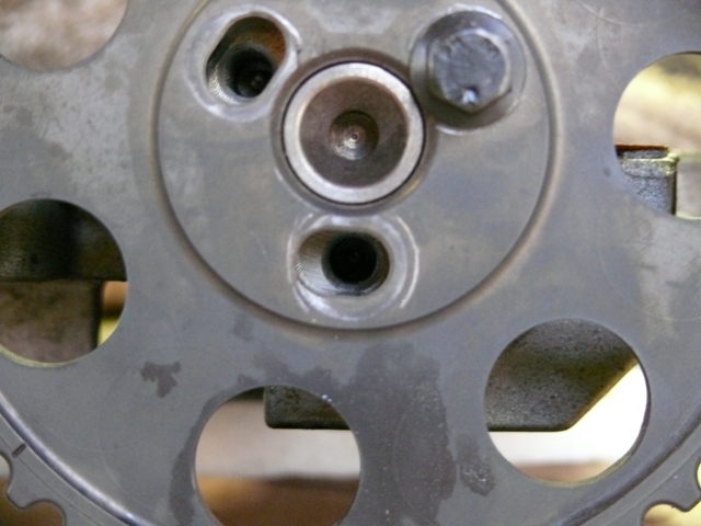

This is interesting. I'm in the middle of intalling my rebuilt head. Here's the exhaust cam sprocket orientation to the cam when the opposite end slot is parallel/offest just below to the mating surface of the top half of the head (which should be timed for TDC). Unless the previous owner had cam seals replaced prior to 89k miles, this is from the factory. So, is this position advanced? BTW, the intake was dead on center.

Sorry, here's the pic.
Exhaust sprocket Web.jpg (137.89 KiB) Viewed 4157 times

That position looks about 3 degrees retarded to me. Check the pic in the first post in this thread. Mine was in the exact same position from the factory.

yea there all retarted on the exhaust cam. even on the 960s S70 and V70. its best set it to center at the very least. i cant tell you why Volvo set them retarded.

tjts1 wrote:That position looks about 3 degrees retarded to me. Check the pic in the first post in this thread. Mine was in the exact same position from the factory.
Remember now that the pics is with the top cylinder half upside down, so the sprocket is actually off center to the front of the car when right side up. Still retarded?
So, I should just shoot for center. Would anyone elect to advance it?
