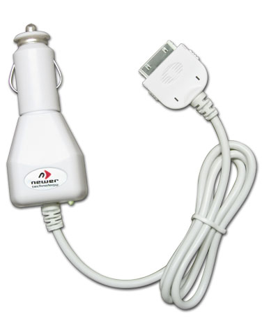

http://eshop.macsales.com/item/Newer%20 ... OADTRIPLS/
Just got one of those. Whooops the crap outta the iTrip because it
a) charges the iPod
b) runs on only one frequency (87.9), and does it well
c) is much simpler -- no frustrating dialing in a frequency on the iPod
a) charges the iPod
