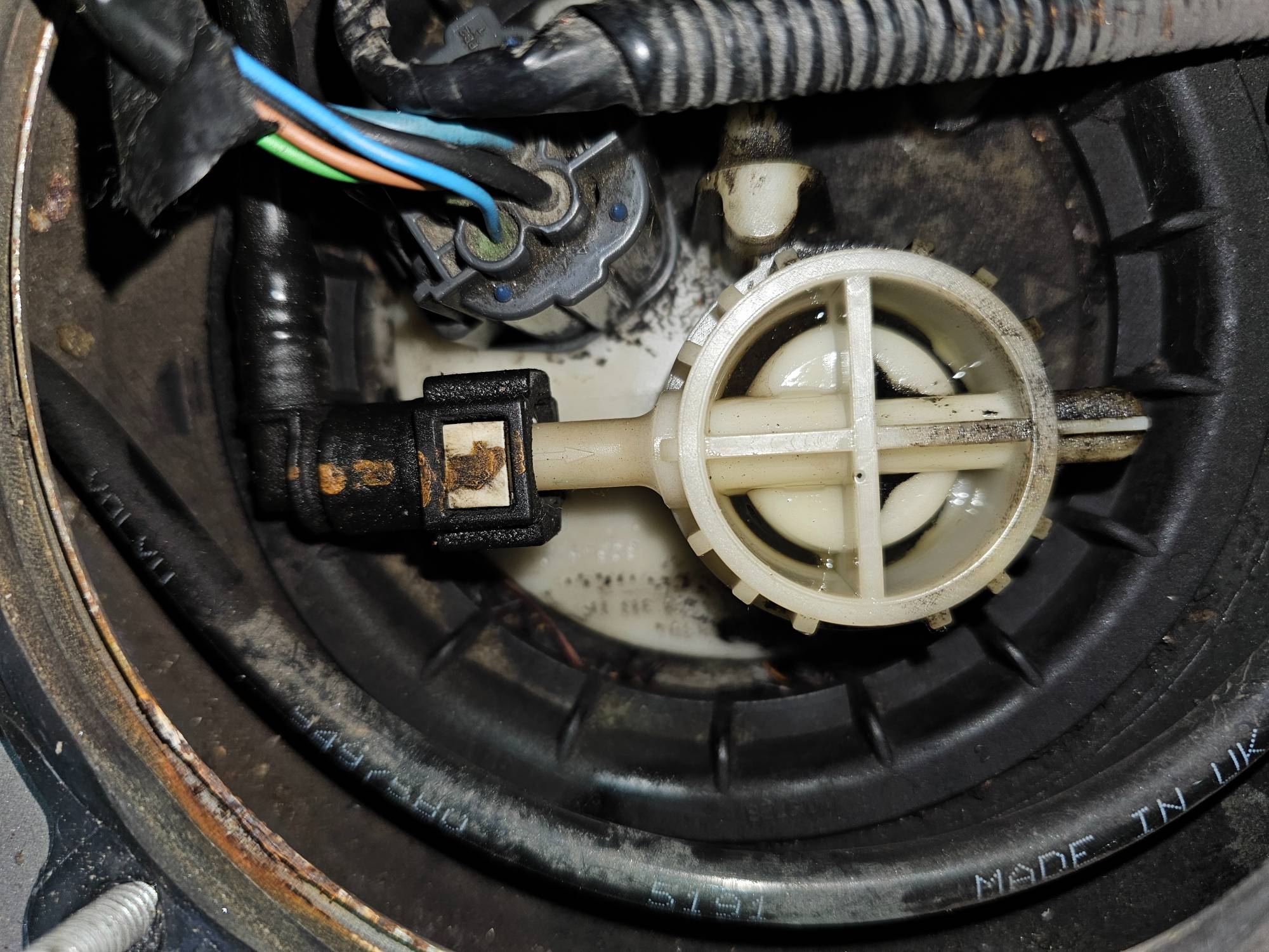

2004 XC70. I first noticed gas smell in interior about two weeks ago. Confirmed a slow, low volume leak from the cap of the fuel pump. See attached photo. No fuel on any other portion of the pump or elsewhere.
Original owner. Car purchased and registered continuously in Massachusetts. Never received notice from Volvo for this recall. Not in the "hot" climates that reportedly are the only ones that qualify for this recall. Correction: a VIN search at NHSTA web site does NOT return this fuel pump recall (only the airbag recall).
Any chance Volvo will replace this pump without charge to me under this recall? It's been a long time and I'm not in the covered locations but it's clearly the same defect and it is a major safety issue. Volvo is just wrong about the locations at risk for this failure. I saw the post above about success getting coverage in New York so maybe there's hope. Then it's the matter of being "late". But, again, since I wasn't notified being late is meaningless.

Read my post above - you should be covered if you push it. I dont think they want the liability of your car burning up.

Volvo replaced my 02 S60 fuel pump a couple years ago. Had well over 150k miles and multiple owners. No charge. I’m in Iowa so not part of the original recall. Had to call Volvo US Customer Service to open a ticket. I filled the small area with fuel resistant two part epoxy to prevent further fuel leaking. With key on you can see where it is leaking from.enotslim wrote: 28 Sep 2023, 16:12 2004 XC70. I first noticed gas smell in interior about two weeks ago. Confirmed a slow, low volume leak from the cap of the fuel pump. See attached photo. No fuel on any other portion of the pump or elsewhere.

Did you get a decision about eligibility before taking the car to a dealer? I opened a ticket with Volvo US Customer Service who says they will not decide whether this car is eligible for *consideration* for replacement under this recall until a dealer evaluates the fuel pump. I'm telling them they can and should decide eligibility for *consideration* before I tow the car to the dealer. (I'm uneasy about driving with fuel leaking near the electrical input to the pump - sparks wouldn't be good - am I too cautious?) If the fuel pump doesn't qualify for the recall then of course they will not need to cover the replacement cost. I'm not asking them to commit to covering the cost sight unseen. I will, of course, replace it myself if they won't cover it.Krons wrote: 30 Sep 2023, 20:58 .....

If I recall correctly I did take it in, with backseat removed so dealer had a clear view of the pump and could not charge me a diagnostic fee.enotslim wrote: 03 Oct 2023, 19:54dono wrote: 28 Sep 2023, 20:08 Read my post above - you should be covered if you push it. I dont think they want the liability of your car burning up.Did you get a decision about eligibility before taking the car to a dealer? I opened a ticket with Volvo US Customer Service who says they will not decide whether this car is eligible for *consideration* for replacement under this recall until a dealer evaluates the fuel pump. I'm telling them they can and should decide eligibility for *consideration* before I tow the car to the dealer. (I'm uneasy about driving with fuel leaking near the electrical input to the pump - sparks wouldn't be good - am I too cautious?) If the fuel pump doesn't qualify for the recall then of course they will not need to cover the replacement cost. I'm not asking them to commit to covering the cost sight unseen. I will, of course, replace it myself if they won't cover it.Krons wrote: 30 Sep 2023, 20:58 .....

Thanks. It's fairly easy if I drive the car to the dealer. I'm hesitating due to the perhaps wiser plan of towing both ways if they don't cover it.Krons wrote: 05 Oct 2023, 10:40 If I recall correctly I did take it in, with backseat removed so dealer had a clear view of the pump and could not charge me a diagnostic fee.

On mine it was easy, they just had to look at my epoxied fuel pump top (I didn’t want fuel blowing up my car) and smell the gas from the seat bottom. All they really need is a “yup, top of fuel pump is cracked” so they can work a ticket with Volvo USA. I don’t know why dealers sometimes make it more difficult than needed.enotslim wrote: 08 Oct 2023, 12:39Thanks. It's fairly easy if I drive the car to the dealer. I'm hesitating due to the perhaps wiser plan of towing both ways if they don't cover it.Krons wrote: 05 Oct 2023, 10:40 If I recall correctly I did take it in, with backseat removed so dealer had a clear view of the pump and could not charge me a diagnostic fee.

Dealer won't look at the fuel pump with epoxy (to stop the leak so I can drive it in). That means towing, both ways if Volvo US rejects coverage under the recall (and I replace the pump in my driveway or just try epoxy at that point). Any way to reversibly stop/slow the leak enough to drive 5 miles to the dealer? Inflatable balloon stopper? If not I guess I tow and hope. They will do the air bag recall at the same visit.Krons wrote: 10 Oct 2023, 14:52 On mine it was easy, they just had to look at my epoxied fuel pump top (I didn’t want fuel blowing up my car) and smell the gas from the seat bottom. All they really need is a “yup, top of fuel pump is cracked” so they can work a ticket with Volvo USA. I don’t know why dealers sometimes make it more difficult than needed.

My kid had drove his S60 for a while before I caught it. All depends on whether fuel is a small containable leak or a spray. If you pull the rear seat to expose the pump and key on, you should get a feel of whether it’ll be ok to drive 5 miles.
Keep the windows down when you drive.
