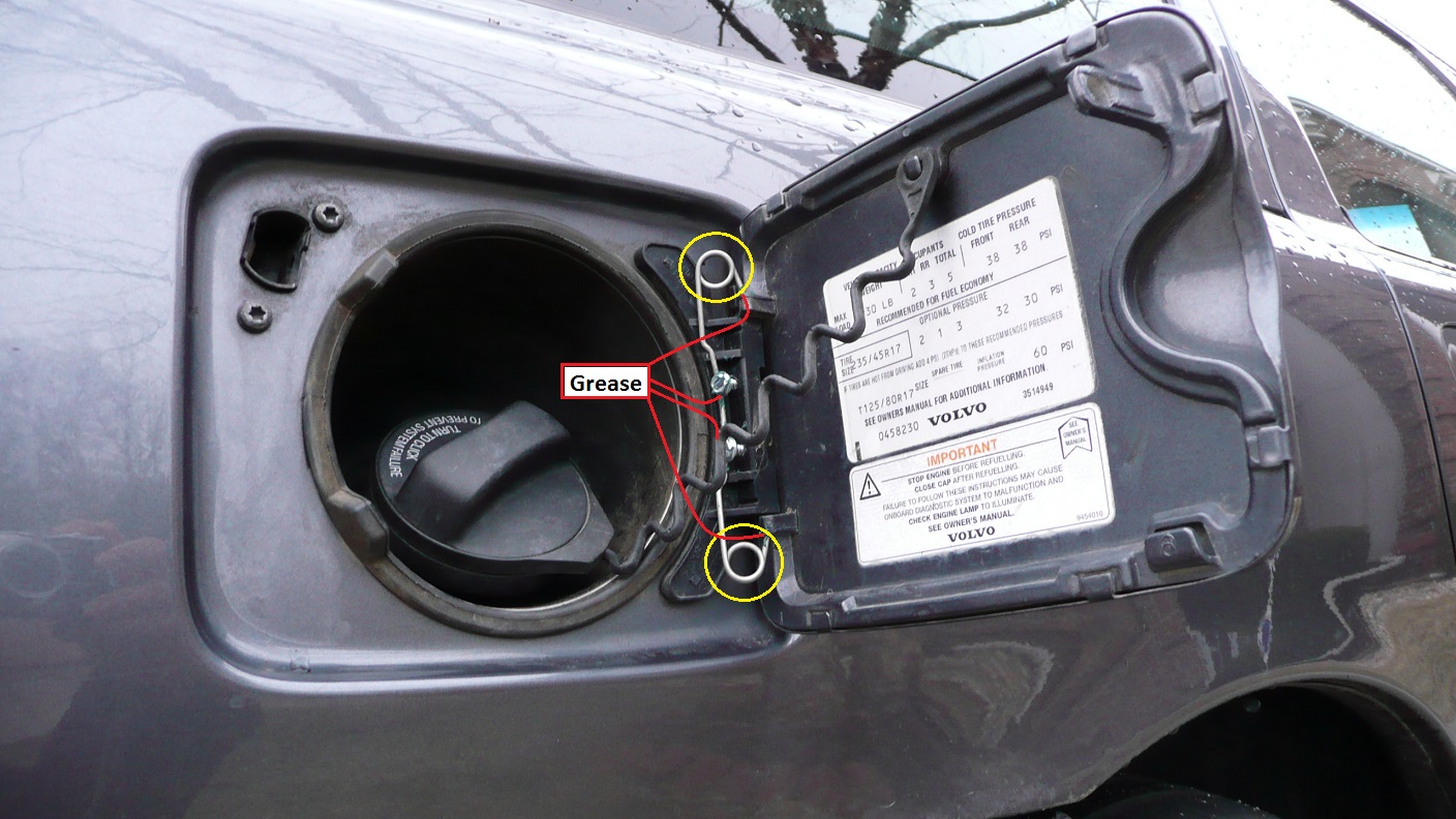

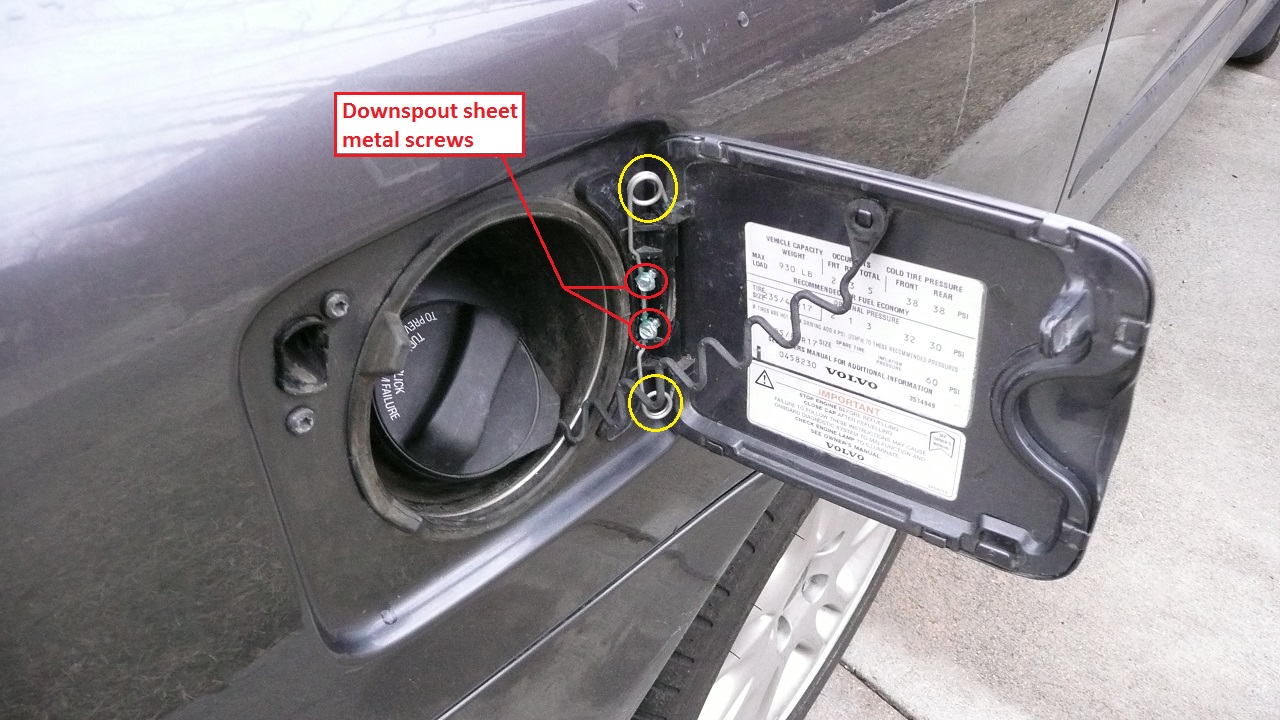

- Magnet is a great solution.
- In a previous post, some people drill through body metal, I don't like it b/c of risk of rusting later (may or may not be important).
- Photo above by "Volvo Ocean Race" using "Cable Tie" is nice, but not everyone has the Cable Tie.
- My solution is very simple:
* Go to your local roofing/gutter company and ask for 2 sheet metal screws, these screws are galvanized and should not rust (or you can paint them with black paint when you are done).
* Drill 2 pilot holes toward the front of the car, this way the screws do not pierce the body work.
* These screws work perfectly b/c once they are about 3-4mm into the plastic, they hold the spring against the plastic frame.
* Note the orientation of the spring: the "short ends" go inward.
* I added a bit of grease where there is movement.
- That is it folks, it is a FREE fix! It works perfectly...

I can appreciate the breakaway hinge design. But the hinge itself isn't what causes all the anguish. The little nubs that retain the tension spring need to be wider so that they don't break so easily. Same as retrofitting little screws as a repair, reinforcing this shouldn't interfere with the plastic hinge assembly separating from the body of the car if you stumble while fueling the car.

- Just fixed the door spring issue (2 sheet metal screws) on my driveway. Locked the door using master lock driver's side (turning the tumbler twice clockwise as usual).
Next day, came out...the fuel door is not latched by the electrical motor, i.e., pin from electrical motor is NOT extended out to latch the fuel door.
- Drove to work, parked the car. Checked the fuel door, it was latched, i.e., cannot open my fuel door.
So:
1. The business of locking the master door and "wait 10 minutes so the fuel door is locked" did not work for me.
2. Driving > 10 mph did the trick.
