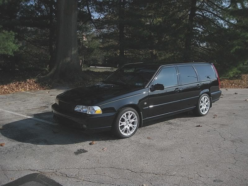

Anyhow ny wife's BLACK 2000 VR is essentially swirl free and has been for 10 years.
Both owners before me obviously took decent care of it but I have managed to make it look almost as new.
I DO take it to the car wash at times especially during the winter (the horror) and that does give it some light swirls but nothing deep and nothing that cannot be buffed out.
I use an inexpensive 10" orbital buffer (Pep Boys, $35 IRRC) and most of the time I start with Mequiars 2.0 swirl remover, then Meqiars #7 (the original!) then Mequiars NXT wax ALL using the buffer.
3M commercial polish for dark colors in the black bottle also does a terrific job
