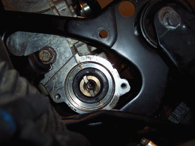

I removed the distributor and the camshaft position sensor to check the camshaft timing slots. The axis of the camshafts is below the top of the fenders so it is very difficult the check the alignment visually. I tried taking a photo with my camera in line with the axis of the camshaft but it is time consuming and inconvenient to transfer the photo from the camera to the computer to view the image.

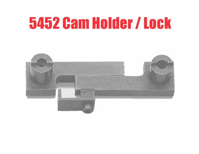

Below is a photo I found on the internet of a Volvo camshaft alignment tool.

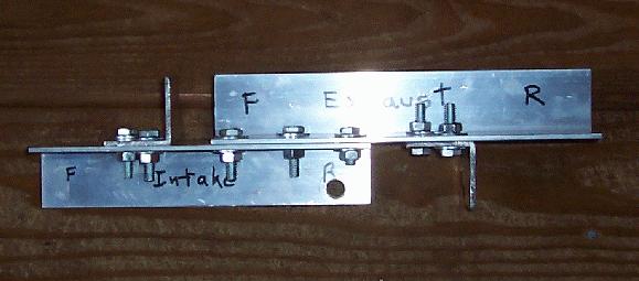

I decided to fabricate something similar from aluminum angle stock, nuts and bolts.

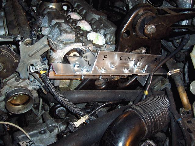

Here it is in use.
The tool is not strong enough to actually align the cams. It only serves as a visual reference. The 1/8 inch thick aluminum is less than the thickness of the cam slots so the tool is pushed downward on the intake cam and upward on the exhaust cam. using the tool I believe I was able to align the cams accurate to 1 or 2 degrees.

Looks like you are well on your way. Does it look like the cams were aligned correctly? People seem to be afriad of these cars, but if you take a little time to get to know them they can be pretty rewarding IMO.
I made a ghetto cam lock out of mild steel. It was fine for the alignment, but when I had to torque the center cam spricket bolt to 88ft\lbs things went a little pear shaped. I might make another one and try and temper it. The 850 doesnt have VVT so no worries there.

The intake camshaft required no adjustment but the exhaust camshaft was a few degrees off which I corrected.

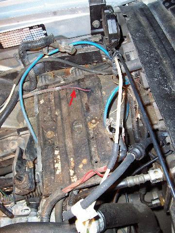

I bought a new group 47 battery with 590 CCA at WalMart. When I removed the old dead battery I found a vacuum hose underneath it.
I suspect this is the hose that connects to the cruise control vacuum pump. Does anyone know where the vacuum pump is supposed to be mounted?

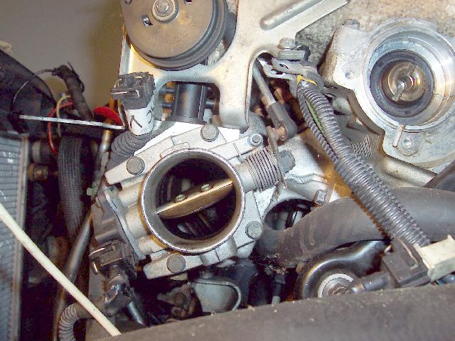

I wired the throttle plate open in preparation for performing compression testing. There was considerable linkage binding at the mid-throttle position and the linkage prevents the throttle plate from reaching WOT.
I'll work on the linkage after I get the engine running.

The vacuum pump is mounted to the bottom of the battery tray. My purple vacuum line is not routed through the hole but around the tray to the pump.
There is a battery hold-down wedge, probably missing, you can get at the dealer cheaply enough.
When you figure out the binding on the throttle, I would be interested because my throttle is getting hard to push. I am waiting until spring (warmth) before I open up the throttle body and inspect everything.
