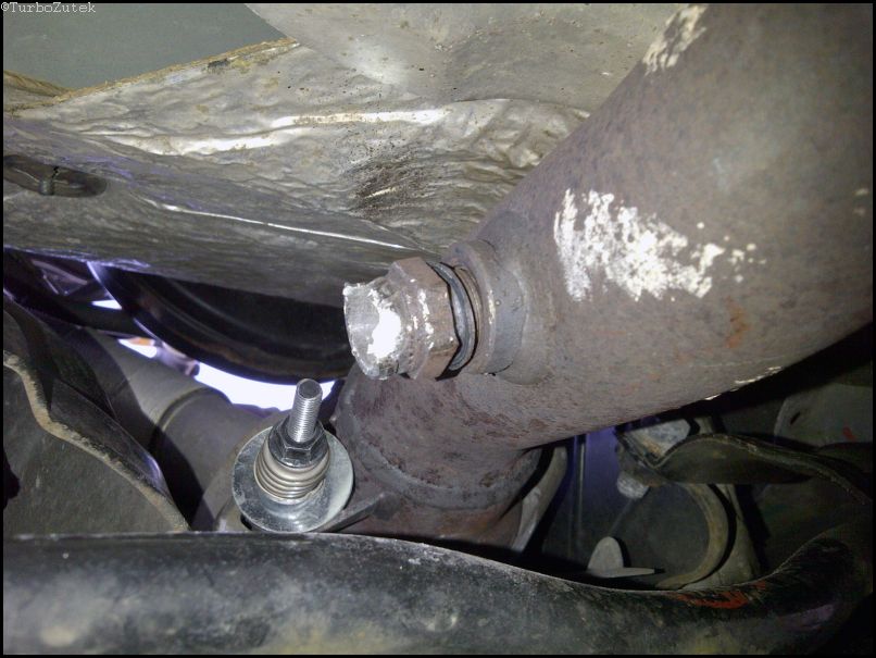

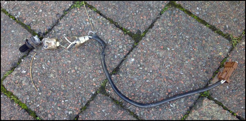

Post by turbozutek »
Get a cheap nut splitter. Put it across the oxy sensor and start to tighten down on to it.
Which will give you this:
Hacking Off The Oxy Sensor.jpg (89.46 KiB) Viewed 2080 times
Remove with a socket and an extension bar.
You get this:
Oxy Sensor 'Adjusted'.jpg (122.66 KiB) Viewed 2080 times
But more importantly, this:
Hole Finally Ready.jpg (92.25 KiB) Viewed 2080 times
Job done!
Chris...
